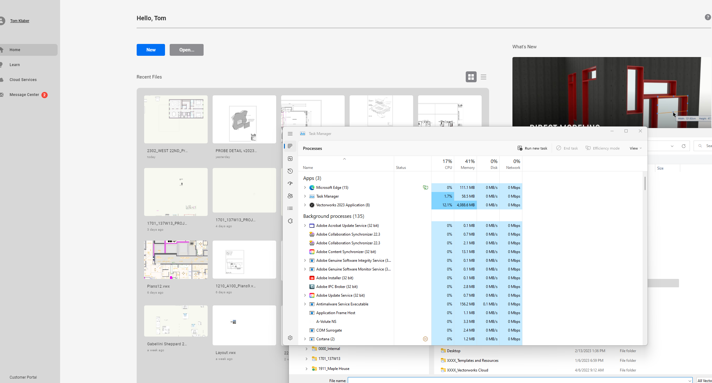

6 hours ago, Tom Klaber said:
New low....
Vectorworks freezing and consuming 42% of memory with NO FILES OPEN - just the new home screen.
@Tom Klaber, Your screenshot doesn't show Vectorworks using 42%. That percentage at the top represents the total memory consumed by all processes currently running on your computer, including the operating system and other programs. If Vectorworks' use of ~4GB is 42% of your total memory you probably need more memory for your work as Vectorworks 2023 does indeed have a higher baseline than Vectorworks 2022 did.
In relation to Vectorworks using more memory when all files have been closed vs when Vectorworks is first opened:
If you have had a Vectorworks file open this session Vectorworks will retain some aspects of your interaction with that file in memory. I wouldn't expect those to remain indefinitely but if they did and it wasn't in order to offer some benefit to the user - such as being able to reopen that file faster - then it would warrant a bug submit or a enhancement request.
Link to comment
  • 0
Correct.  Not using 41% of memory - but fact remains - crashed with no file open.
Link to comment
