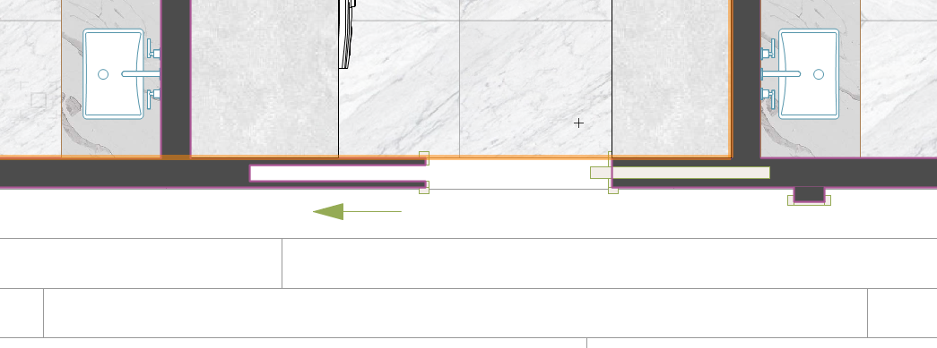

BUG _ 2026 - SP3 - Pocket Doors Do Not Flip Correctly
Tom Klaber replied to Tom Klaber's question in Troubleshooting
It does work as long as you do not have more than 1 pocket door in a wall - otherwise - you can end up flipping them both. Regressing back to SP2. This feels sloppy. Fairly disappointed here. Between the wall stuff the LOD stuff - and now the door stuff - VW2026 is off to a rough start. -
The reverse wall direction does seem to work. -
Really? So we just have to show pocket doors wrong until SP4? What would the ETA be on that? We need to have a faster patching for such blatant issues like this. Service Packs should be fixing problems - not introducing them. How can I roll back to SP2? -
Tom Klaber posted a question in Troubleshooting
Pocket doors all of a sudden do not change direction - only the pocket of the pocket door flips - the leaf is stuck in one orientation. -
