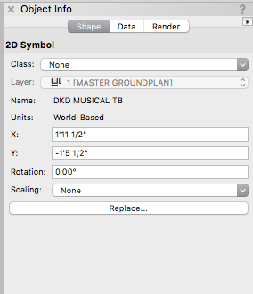

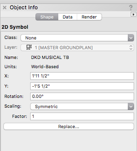

astephens Posted October 25, 2017 Share Posted October 25, 2017 On 9/14/2017 at 5:21 PM, wprescott said: then you cant scale the title block without editing the 2D component.....each time that you use it. You actually can scale - it just looks a little different in the new object info palette. The scaling drop down defaults to "none" so it looks like there are no scaling options. When you change that to "symmetric" or "asymmetric", the scale factor option appears. Quote Link to comment
