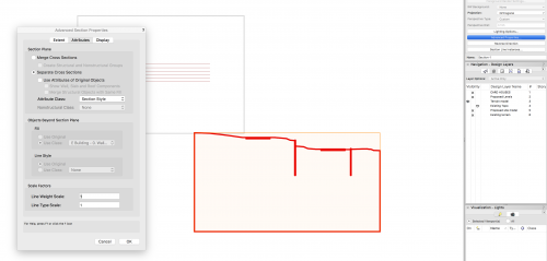

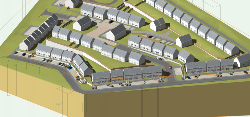

Thank you for your effort and compliments there Alan, You should see the model now! I ended up exporting it to a 3D web view and successfully walked around it with my 3D VR goggles! However, I am familiar with the settings your video ran through and had previously tried changing the classes etc. I have attached a screen shot to show you that I am still having the same problem even after ensuring I followed your instructions precisely. I have attached 3 screen shots. 1 shows the section still with no fill 1 shows the section with a little bit of fill after increasing the minimum elevation 1 is just me showing you what the finished site model looked like Thanks again, and thank you in advance for any further help you can be.
Yes and no, Its strange, It is intersecting modifiers and yet sometimes it shows as a fill, and other times it will not, I dont know if its a bug or wether its my internal origin setting. I actually turn off the DTM class when creating a section (in the viewport) so the section viewport is only showing the modified terrain.

@Alan WoodwellId done a save as at a point before the model got too big. I have attached a dropbox link, there is only 1 sheet in the file, the larger scale viewport shows the terrain with no fill, let me know if you can work it out! https://www.dropbox.com/s/hfxldxb2cthz333/Example of terrain model.vwx?dl=0 Thank you for your time!
Thanks Alan, A bit childish of me to post a sarcastic comment on my own post, I was just very frustrated with Vectorworks, and after 8 days I still received no help Unfortunately the file was way to big to upload, in the end i had to draw over it in the viewport as annotation. Im more than confident it will happen again, perhaps i will reattempt this question in another post one day, with no ungrateful remarks.

Hi Guys, I am creating section viewports through a proposed terrain model with site modifiers all over it. sometimes when I create the viewport, the section through the terrain shows as solid as per my request, and other times using the EXACT same settings, the terrain section is shown as hollow or white. FYI- I am not displaying anything pas the cut line and i have selected separate sections to have the appearance of a class with a SOLID fill Using VW17 at the moment, and to be honest the version of VW doesn't seem to make a difference with my problem. please see example attached. Please help!!
