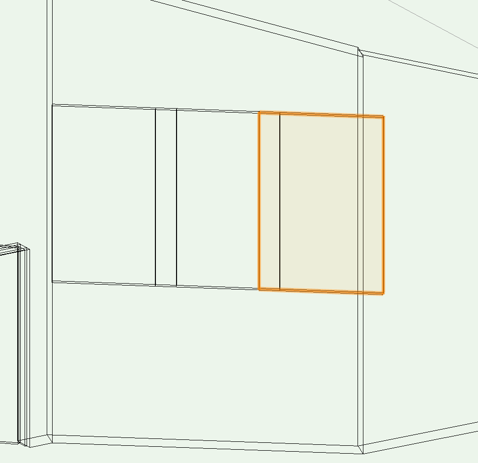

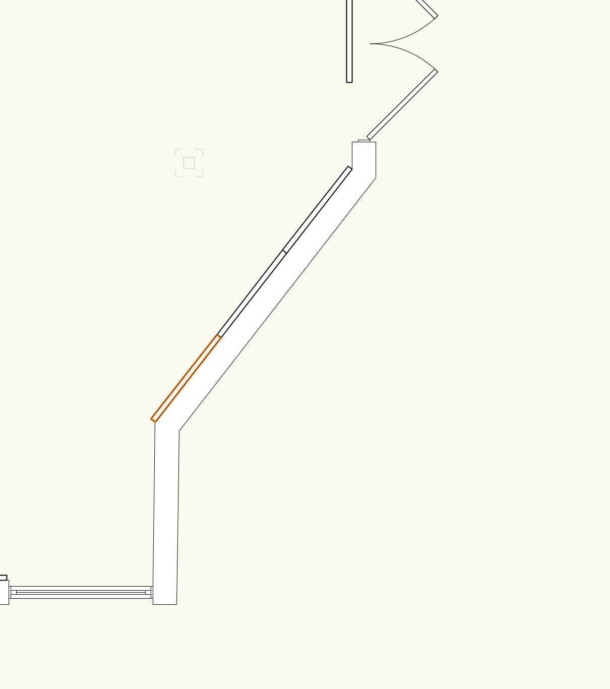

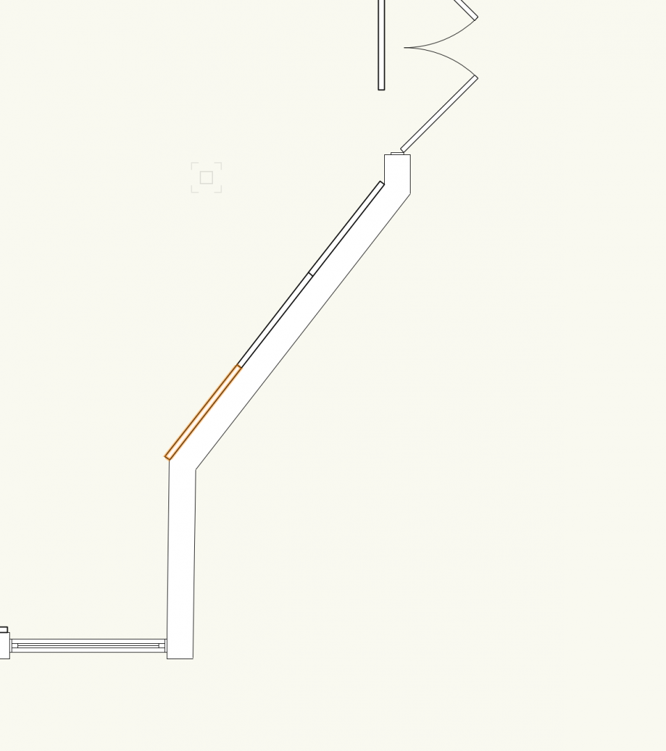

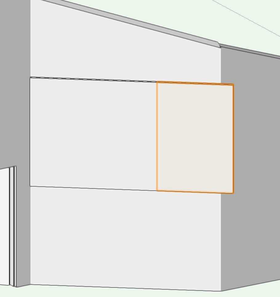

I've got some symbols in my drawing that have been edited, and viewing the drawing in top down wireframe they are displaying correctly, however, they show the original dimensions in viewports and OpenGL. I've closed VW completely and restarted the program, no fix. I'll try shutting the whole computer down next, but so far I cant figure out whats going on. I'm pretty new to this so I could just be missing something easy, but this is not something I can share with the customer.
