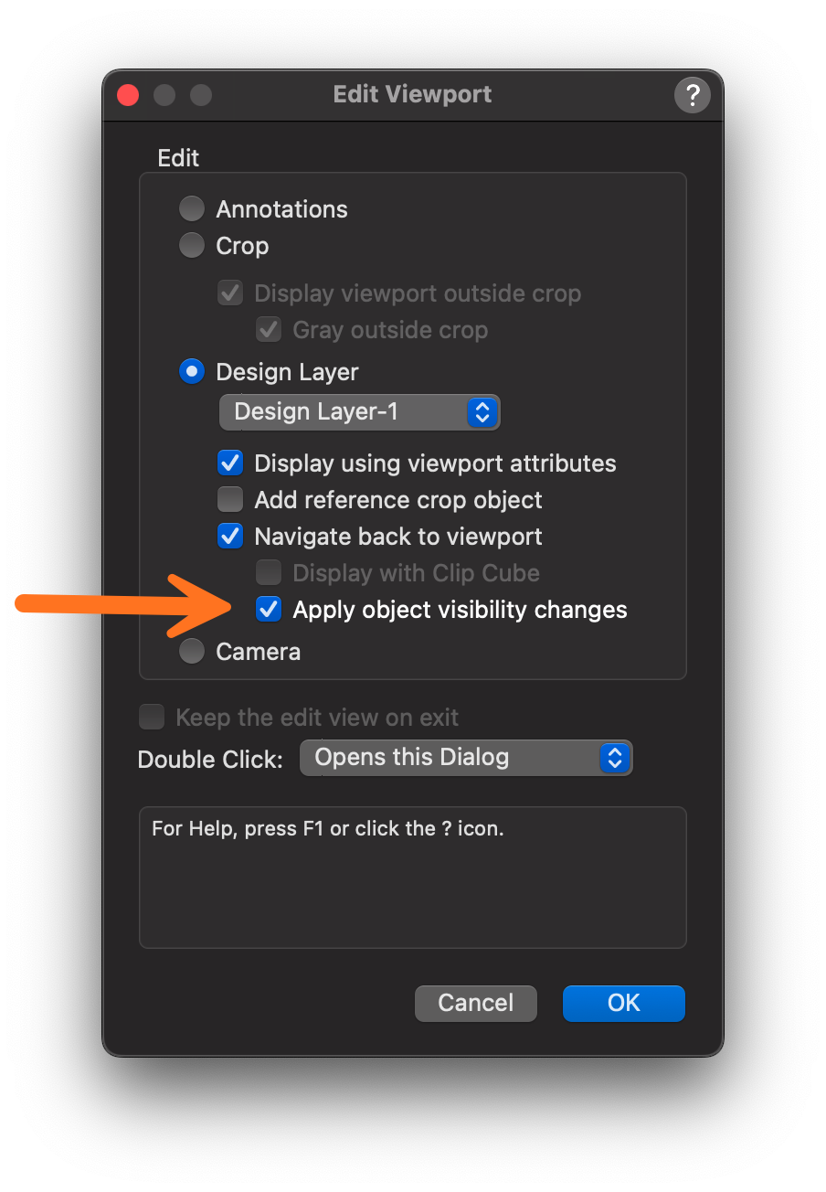

On 3/21/2025 at 1:57 PM, nwfonseca said:
Yes, I have that ticked. I learned that the hard way. It doesn't happen instantly though. For instance, I worked on the file yesterday but when I started today random stuff was visisble.
It (the revised visibility of objects) should happen the moment you exit the orange-bordered "Edit Viewport" mode. The feature is designed to work that way and it functions that way for me. If you are experiencing a delay of object visibility changes after editing a viewport with that option checked on, then I recommend that you contact our technical support team and report what you are experiencing to them so they can assist you.
3 minutes ago, Elite Exhibits said:
New in 2025 ? ...is it checked as the default ?
Yes, new in v2025, to go along with the new Object Visibility feature.
Full info about it can be found here and if you go to the What's New in 2025 web page, below the recent update into there's a new feature video on the topic.
I believe the default is that it's unchecked, but I don't recall and my application has now been tuned to my workflows.
Personally I have mine unchecked because I typically set the visibilities of objects I want to appear in the viewport, then I make my viewport. If I enter the viewport's Design layer and adjust visibilities in order to make some design changes, I don't want those visibility adjustments to get sent back to the viewport. But, when I know I'll be making some visibility changes that I do want to have sent to the viewport when I'm done, I switch that option on.
@nwfonseca ... If you are editing a viewports' Design Layers AFTER the viewport has been made, changing the visibility of objects, then wanting those visibility changes to "stick", ensure you have this option on:
