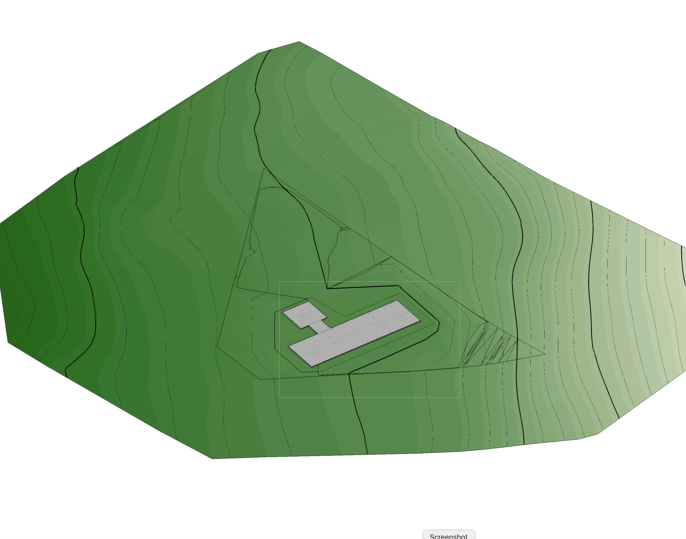

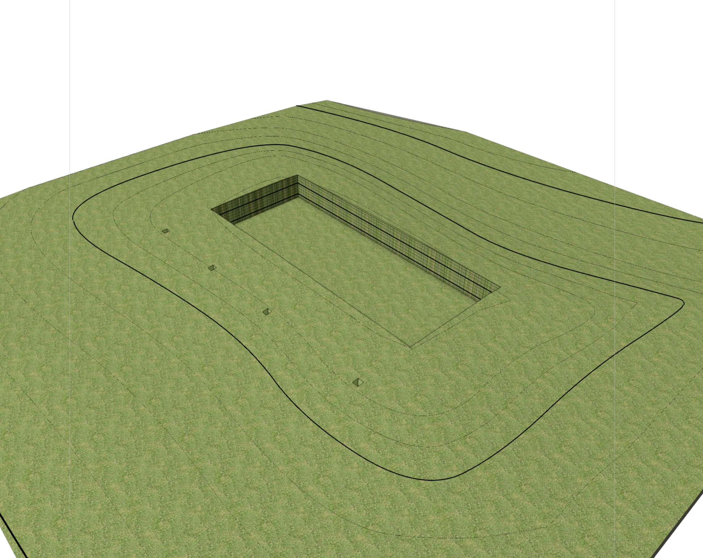

Working with site modifiers - With the first screenshot, a site model with grade limits set and planar pads come out graded into the site. Even if I have vertical sides set to inside modifiers, when I set an planar pad inside the first pad it grades out instead of having vertical sides. With the second image, without grade limits i can easily create a pad with a vertical retaining edge. Is there a way to use both types simultaneously?
