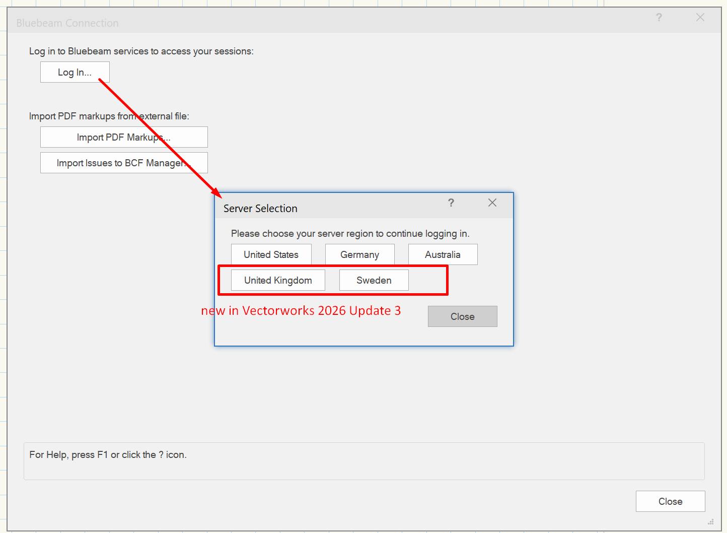

Ireland/UK Bluebeam Connection
Vlado replied to KAAC's question in Wishlist - Feature and Content Requests
@KAAC Thank you for bringing this up. Yes, they've added UK and Sweden as options. You will see them in Vectorworks Update 3, which will come out in January.- 1 reply
