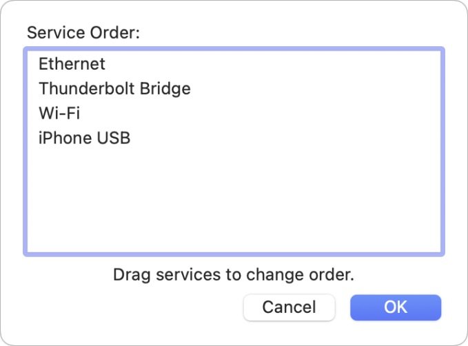

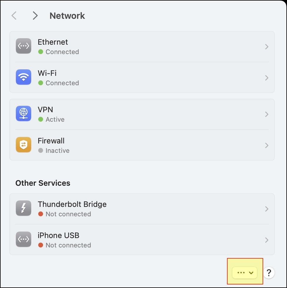

Hey, In macOS, you can set the order in System Preferences when you have multiple active connections. First in list got highest connection priority. … maybe this info can help. Greetings Tobi
