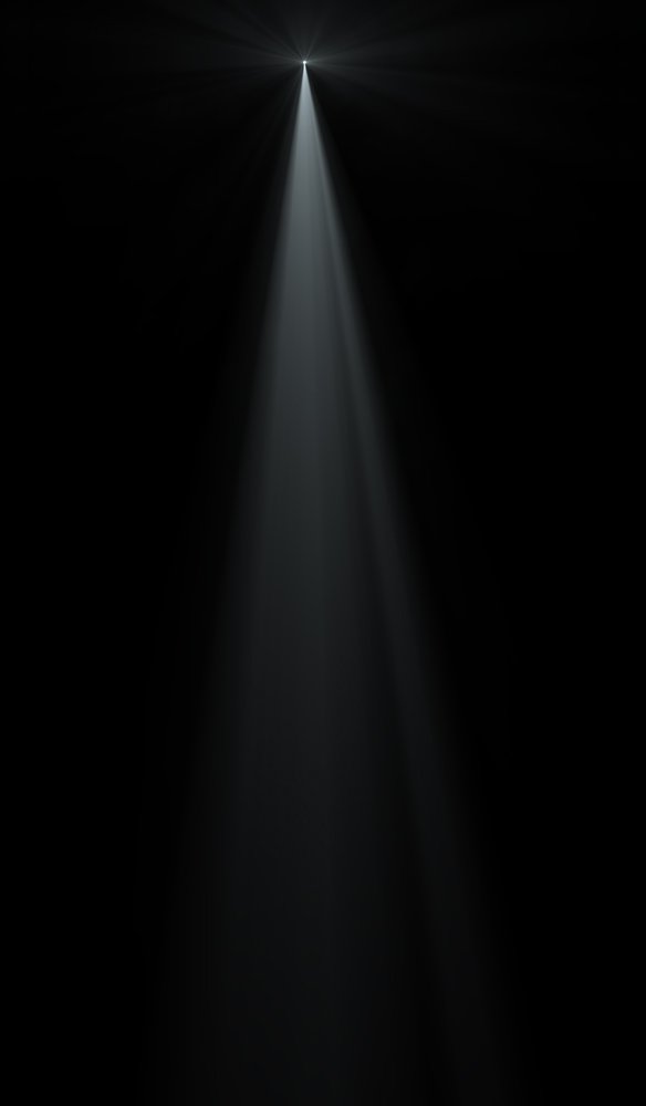

3. Video Copilot makes a add on plug in for After Effects call Optical Flares and it is possible to simulate volumetrics there as well.
https://www.videocopilot.net/products/opticalflares/
In action:
I have also used opticals flares to make myself a library of hi res cones and flares against a black background that I can just screen into a comp in Photoshop to add lights in - though for big rigs, this can be tedious and labor intensive.
I think at this time - the path of least resistance for you is going to be upgrading your Cinema (you should anyway now that you are doing commercial work) and try the STAGE plug in.  It's designed for just what you are talking about - though it's not perfect - full disclosure - I have never used it myself.  Hopefully NNA will address this in the future, but these things take time and I assume there are higher priorities on the list.
