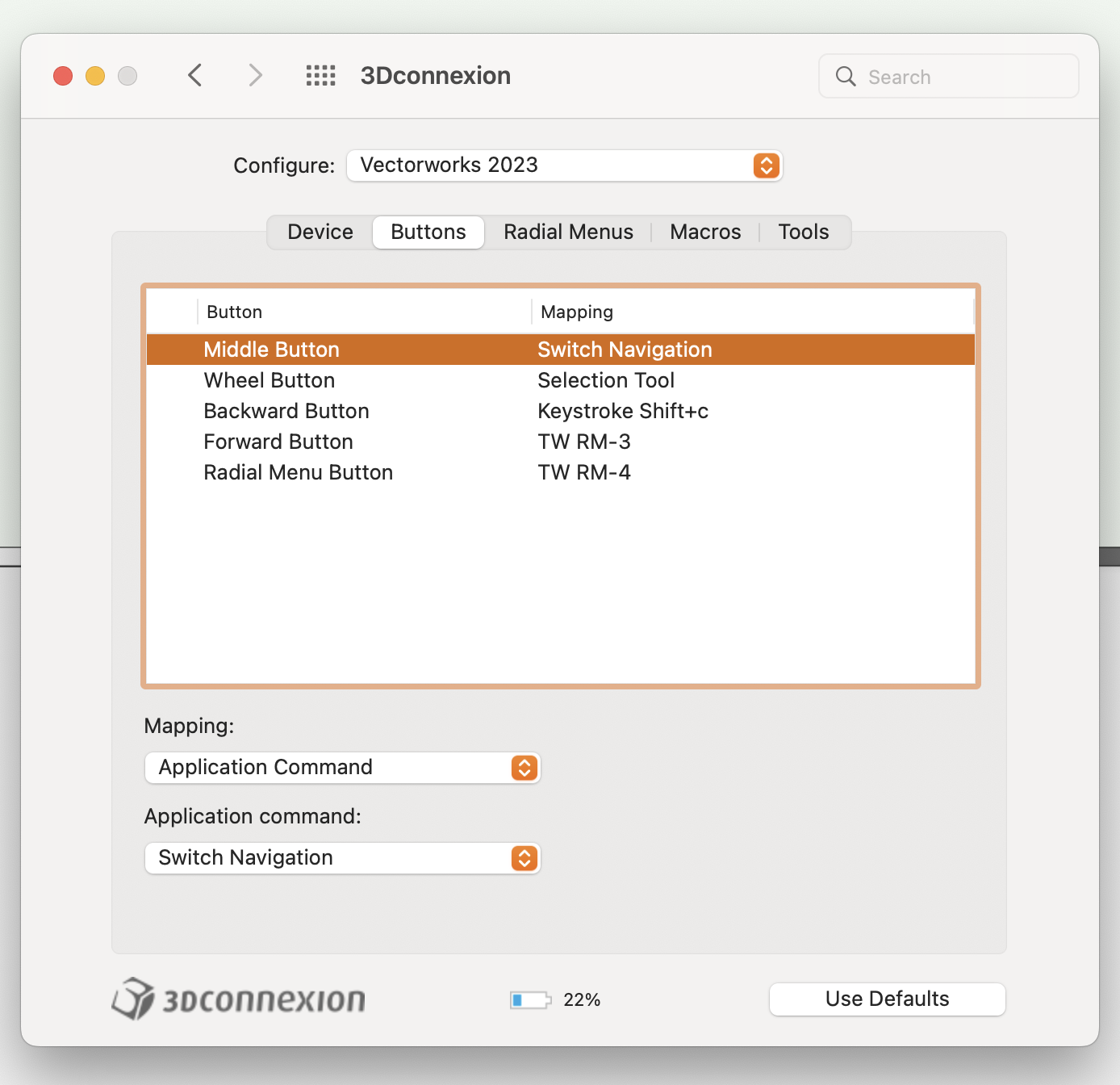

Sorry what exactly are you saying is happening for you? For me, I have 'Switch Navigation' mapped to the MMB of my CadMouse Pro + in previous VW it worked fine but come VW2023 despite the mapping being the same...
588763052_Screenshot2023-05-13at20_15_16.thumb.png.f918eeba797dff0efd0503b243dd447f.png
...in reality what the MMB does is Fit to Objects instead. But for you you're saying Switch Navigation isn't even an option under Application Command mapping? Which driver are you on? As per my post on the 3DC forum, I tried the most recent driver at 3DC's recommendation + things were even worse. I had to revert to the two versions old driver in order to have something remotely useable...
  • Like 1
Correct.
Ah... I didn't see that. I'll try that next...
Link to comment

This is me:
1551638837_Screenshot2023-05-13at20_44_15.thumb.png.e2e179cc2c7ca142dfc6201a13cdde53.png
1206127986_Screenshot2023-05-13at20_43_43.thumb.png.6974992f5b4678ec70dd540c27862570.png
So 'all' that isn't working for me is:
- 'Switch Navigation' is instead giving me 'Fit to Objects'
- 'Fit View' is instead giving me 'Top View'
But on most recent drivers I had a TON of horrible stuff happening
  • Like 1
Link to comment
