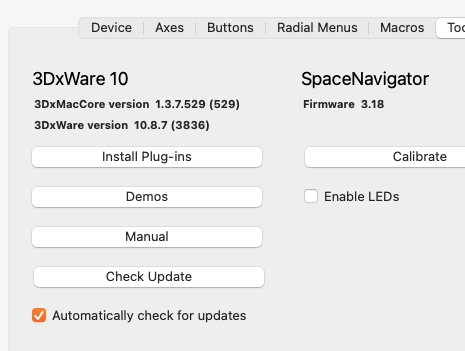

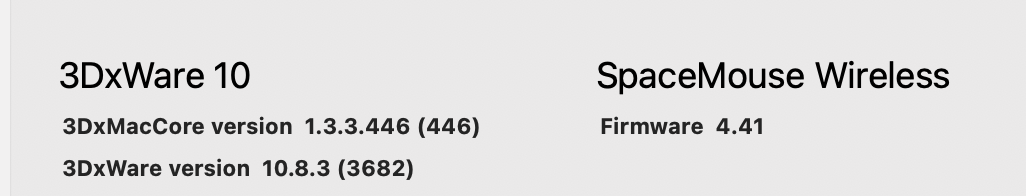

1 minute ago, markdd said:
Currently, I have a perfectly working Space Mouse. But only after uninstalling and re-installing the latest firmware. Here is what I have......
Otherwise, all settings are the defaults, and everything works well.
Ok thanks Mark this is what I'm on I will try your settings:
Interesting you say you're on the latest firmware yet my one appears to be later. I haven't changed anything for at least 6 months. I was repeatedly told to update the version/firmware but every time I did it the performance got worse so I gave up. But no harm trying again!

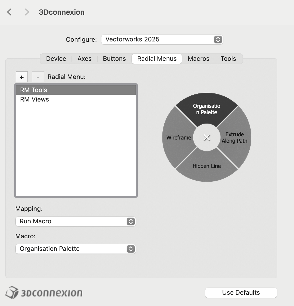

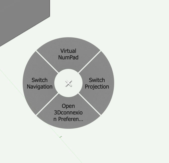

I have installed the latest driver + it's exactly the same. Some of the mappings on my CadMouse are being respected but half of them aren't. None of the mappings on my SpaceMouse are. I don't understand why it's working for you + not for me. This for example is how I have the RM Tools Radial Menu mapped in the settings for my SpaceMouse:
But this is what I see when I use it:
It's the same with RM Views. It's been like this for several years. It used to work perfectly.

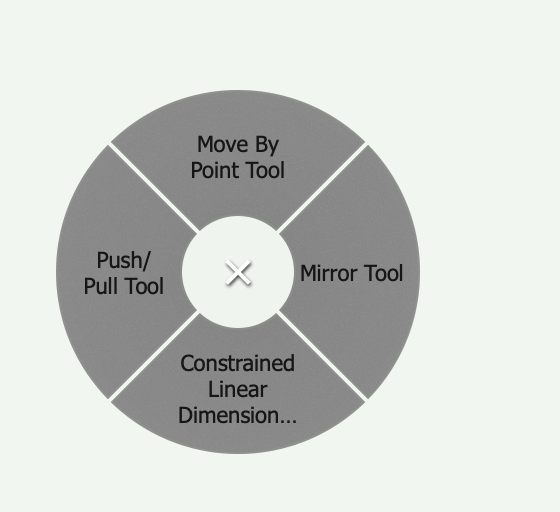

With the CadMouse it's a bit more of a mixed bag but still not working as it should (as it used to). For example this is one of my Radial Menus:
All the mappings display correctly + all of them work except for Push/Pull which does nothing. It used to work a couple of years ago!
