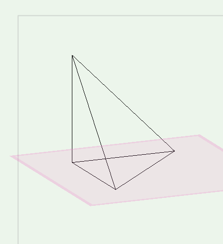

Hi, I'm trying to make a 3D model like the attachment, my thought was to make a block and then cut it along lines, but I can't seem to find the correct way to do that. Am I at least thinking along the right lines, or is there an easier, proper way?
thank,
Peter

Deform tool would work, Split tool may also be what you're looking for from an isometric view:

I think this is one of the few instances I would use the Multiple Extrude command. It would be the quickest. In Top/Plan draw your base triangle and place a 2d loci at the elevated corner. Select both objects and choose Multiple Extrude from the Model menu. Set the desired height in the dialog that opens.

thanks everybody, in the end the deform method worked easiest for me, but i enjoyed getting to experiment with the other methods as well. Will definitely be using these in the future.
