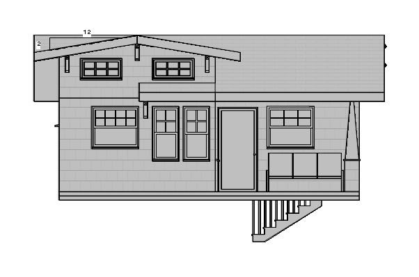

CipesDesign Posted March 25, 2007 Share Posted March 25, 2007 (edited) Joe, It is actually totally possible to do as long as you're willing to model everything from the outset. Here's an example of elevations produced from directly from a model using VW's and RW's. The only thing that's added is the hard edge around the outside perimeter. Hope that will cheer you up a bit. EXAMPLE Edited March 25, 2007 by CipesDesign Quote Link to comment

Fairfax Posted March 28, 2007 Share Posted March 28, 2007 Okay, I tried using other options in Renderworks besides "Artistic" (which gave me a grey background) and in all other modes, the rendering is just a few lines, you basically see nothing. Here is my "best" ouput so far, with two viewports layered, "Hidden Line" above "Artistic Renderworks": http://www.remodelguidance.com/clients/111calumet/testrendering.JPG Why is this so elusive and difficult to achieve? Thanks, though, for all your generous assistance. Graham Quote Link to comment
P Retondo Posted March 28, 2007 Share Posted March 28, 2007 Graham, looks like you lack a "sun" (a directional light that casts shadows) - or else you are looking at the shadow side of the building. Use "Final Renderworks" rendering, be sure you have you layer general lighting turned on (View->Lighting->Set Layer Lighting), and that you have created a sun which is properly positioned and can cast shadows. I often set other non-shadowing lights to give subtle lighting effects. The reason I advise using "Final Renderworks" is that it often gives the best effect for the least effort. Also, it will use the greatest % of processor power if you have multiple processors and hyperthreading. Quote Link to comment
