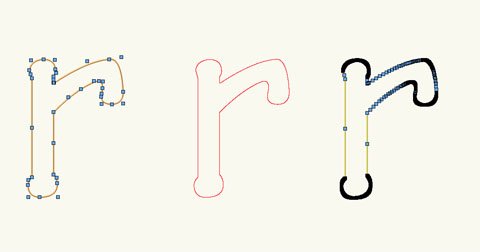

It has struck me for years that breaking arcs and poly lines into line segments has a huge impact on file size and RAM usage. If engineers could focus on how to preserve more efficient objects, that could be the single most important key to better performance. Simplifying Pat’s analysis, a line segment has 2 points, an arc has 3 (end points and radius or center, or some vector equivalent ). Breaking an arc into just two line segments is already less efficient. Going with segmented polylines that eliminate redundant endpoints would be a small step in the right direction.
