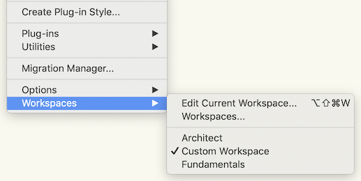

Vectorworks 2024 opening with the default workspace and not my personal one
Gadzooks replied to Jhchambers's question in Troubleshooting
Sounds like you may have to set ✔️your preferred workspace - which should be in your User Folder - if its reverted to default choice. (my V2018 screen grab) Best -

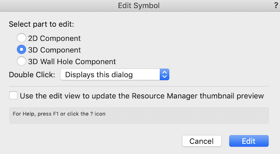

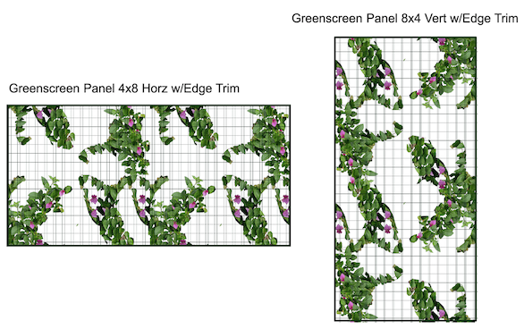

Just noticed a better trellis that might be the type you're talking about. Take the symbol in the resources, duplicate and name it as you wish. Then make the change to the 3D element.....
(trying to guess the issue!) Where did you acquire the trellis from? If its a standard VW offering from your Resources, there's usually a horizontal version (same size) you'll find within the collection. Example....... You'll be able to see the type of resource it is from the OIP. The ones above are 2D/3D Symbol and if you'll want to change the one you have (as its the only orientation) you'll need to double click it to access the elements you want to change. You'll then have to pick apart the symbol to make the changes you wish - and then save as your own Hybrid. I'm running 2018 so you may see some difference in the version you're running. BTW It would be helpful for others if you show your version/system etc in your signature. Come back with further info if you need specific changes - someone might take your (included) file and change it if you ask nicely 🙂 Best
