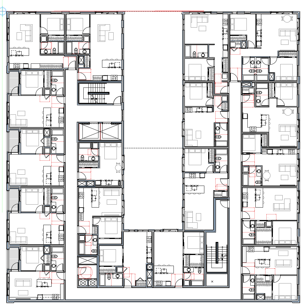

Hi All
We've recently started using a project sharing workflow with Vectorworks Cloud Services (though I've recreated this issue with dropbox as well) and one thing we started noticing is that we're getting some random data loss.
Objects and walls are disappearing at random. I've attached a before and after. I saved and committed, closed out of the working file and reopened the project file and objects that were there have disappeared. I'm the only one in the file at the time and no additional changes were made. I can pretty reliably recreate this everytime I save and commit and reopen the project file, but there's no pattern to what disappears.
Let me know if there is anything we're doing incorrectly.

 I'm starting to notice a pattern. The objects seem to be disappearing pretty much exclusively from symbols. When another user updates a unit symbol for example to update an area or make another adjustment after they've committed their changes and other users update their file walls and other objects in those symbols seem to go missing. Once again this isn't a class visibility issue they just disappear.

The behavior that is an issue is really that objects are dissapearing from symbols even though they aren't edit or modified at all by any users. I'm hypothesizing that its linked to having to do with project sharing as it only occurs in files that have been made into a project sharing file. Data loss in symbols doesn't show up in regular VWX files.
I even tried moving all our unit plan symbols to an external .VWX file and referencing the symbol to the project file. Objects and walls are still disappearing from the unit symbols in the project file even though they are referenced in. If you open up the referenced file those objects are still there.
EDIT: I should say I know that it is a loss issue as I've been the only one in the files as of late, so other users changing things is eliminated. We've also tried using different project sharing methods ie Project sharing server, VW Cloud, and dropbox and have expirienced the same issues.

Here's an example of the data loss. A door has disappeared from this unit symbol and you can see that no changes were made to the referenced file. Going back to the referenced file you can see the door is still there. You can correct this by editing that symbol again and saving, but you can see why this is an insidious issue as this happends seamingly at random and its tough to quality control our documents. Same issue was happening when the unit symbols were hosted in the project file as well, this method just allows us to revert should any data loss happens.
If somone edits the referenced symbol in the project file it will bake that data loss back to the referenced file so its not just a visibility issue those objects are acutally dissapearing.  I'll see if I can find an example to show for that as well.
