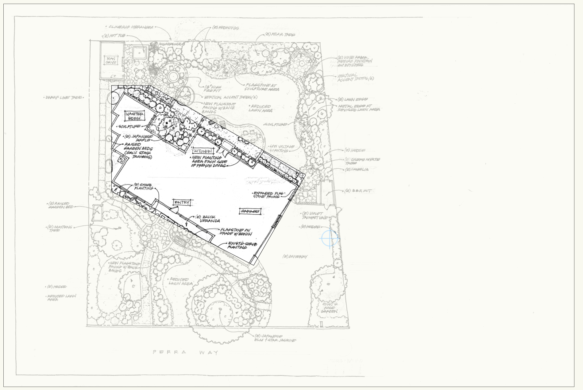

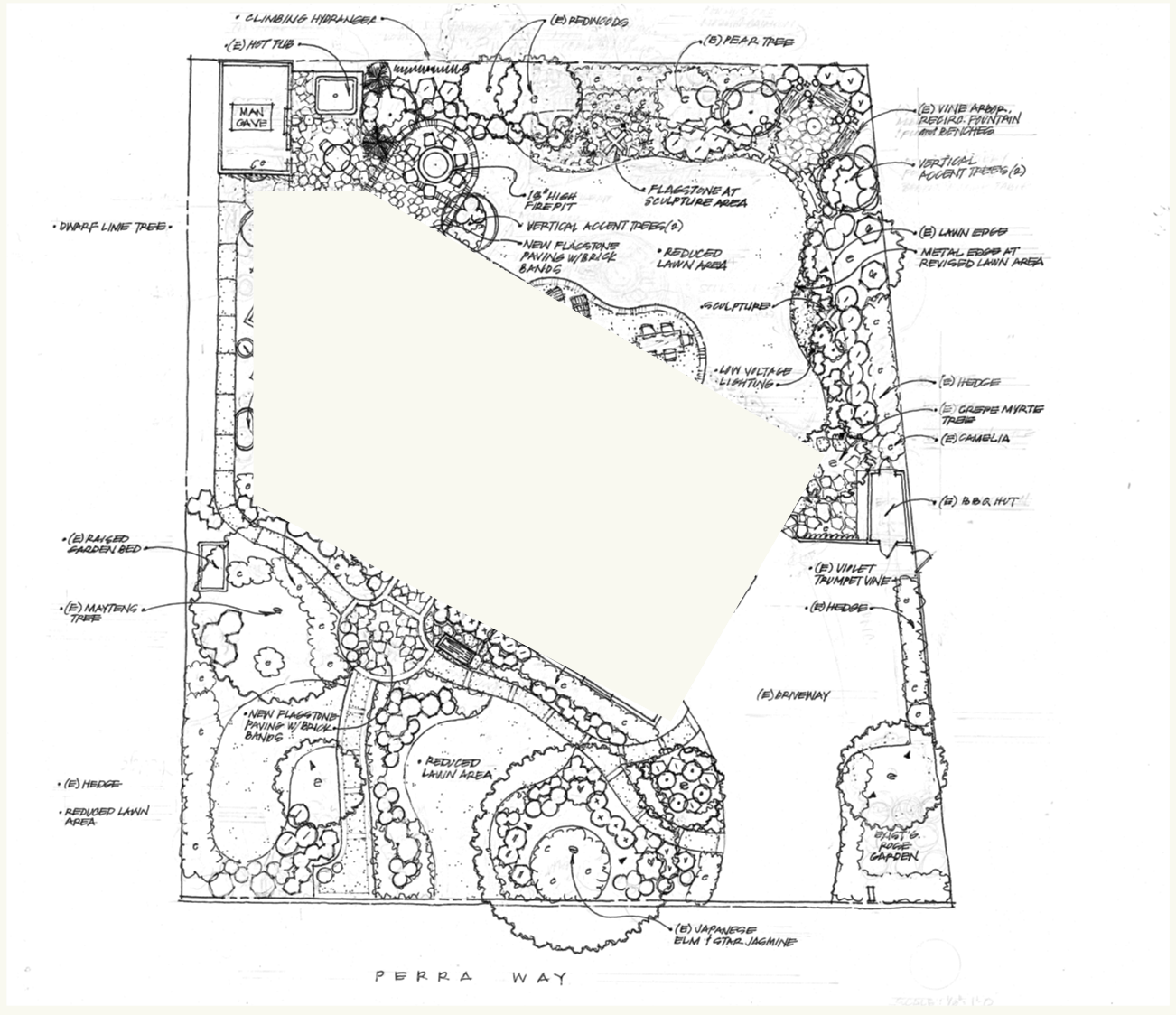

Hi David - That will work, but for the OP won't provide the interactivity (if I can describe it like that) of some sort of 'now you see me, now you don't' construction 'veil'.
