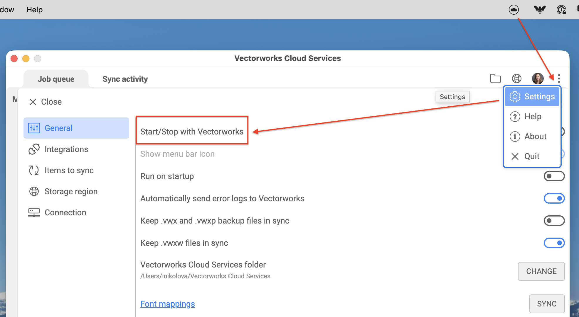

@Dubman I was referring to the Vectorworks Cloud Services desktop app. Here is a screenshot explaining where to find the setting.
@Thomas Wagensommerer, in the app settings -> General, there is a setting that allows you to "Start/Stop with Vectorworks". If you turn that on, the VCS app will only run if you have Vectorworks running.

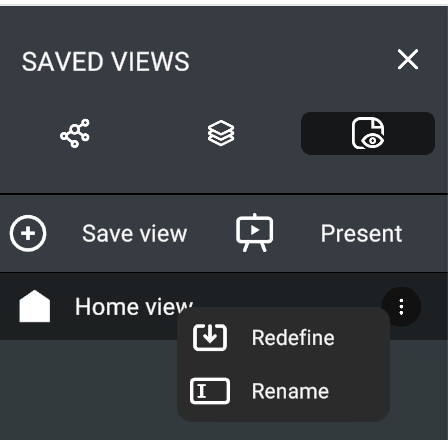

Hi @line-weight, Yes, we only support saved views that are created in the viewer at this time. Exporting a new version of your model will preserve the saved views you created in the previous version, so you only need to create them once and continue updating them as your model evolves. I hope we would be able to support export for saved views from the Vectorworks file in the future. I can't provide an estimate at this time, because this team is currently focusing on a different project, which is to update the viewer, so that it combines 2D and 3D views. You would be able to switch between plan, section, and 3D views. Preserving the saved views from the Vectorworks file would make a lot more sense after that. Best regards, Iskra Nikolova -

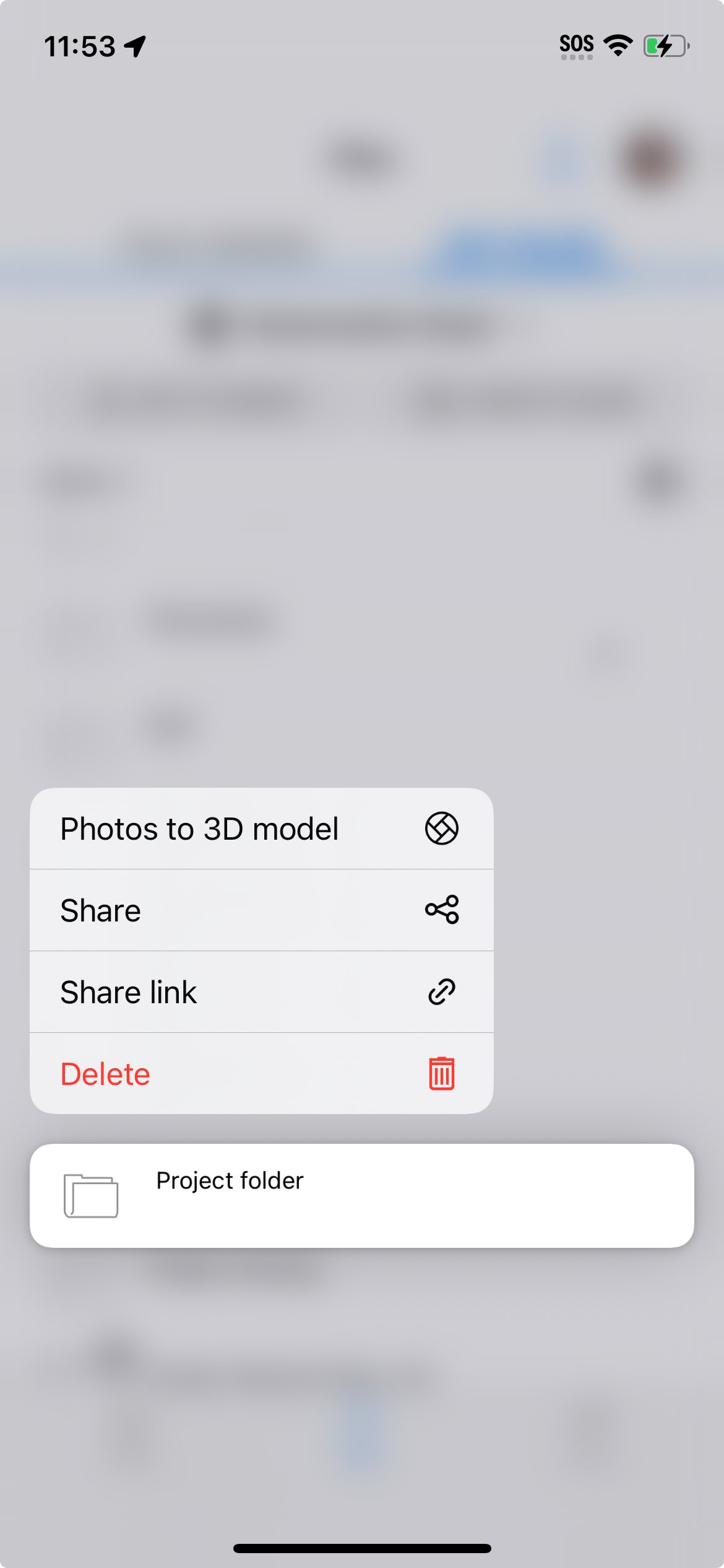

@jnr, The TXT and TIFF files are beneficial to the Photos to 3D model processing. They include depth and orientation data that aid in object reconstruction. To select the entire folder for processing, you need to be one level up, not iside the folder itself. In your case, you need to be in nomad/Vecotorworks cloud/Files/myfiles/ and tap and hold the "project folder" from the file list. You will see this context menu.
@jnr iOS Nomad was recently redesigned, so the location of the Reality capture tools is easier to discover. Multi-select is not yet added as a feature in the new app, but for Photos to 3D model, you can tap and hold the folder where your photos are (make sure you don't mix photos from different scans in the same folder) and the Photos to 3D model is available as a context menu option. I hope this helps. Please let me know if I can help with anything else about Nomad.
