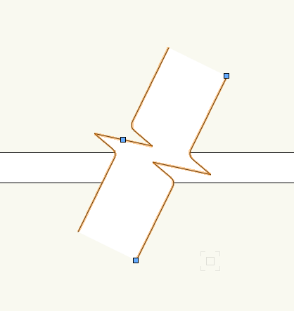

Taproot Posted July 2, 2019 Share Posted July 2, 2019 We use the "Breaker_v1" custom tool instead of the built-in VW breakline tool. I think it is superior. It allows for double breaks and uses a fill between the breaks to look correct. I can't remember if it is a paid plugin or free ... or even where I got it. If anyone else can remember where it came from, let me know .... if it's free, I would be happy to post it here. Icon: Quote Link to comment
Boh Posted July 2, 2019 Share Posted July 2, 2019 That is a great little plugin. I downloaded it off this very forum some time back, so I hope it was free! The plugin vectorscript calls up the author as: "dbelfm@sonic.net". Quote Link to comment
Popular Post Taproot Posted July 3, 2019 Popular Post Share Posted July 3, 2019 Boh - that was helpful. I was able to reach Dan Belfiori (the author) via email and he gave his blessing to share the tool here. See attached. McBreaker_v1.vso 6 Quote Link to comment

Andy Broomell Posted May 21, 2020 Share Posted May 21, 2020 Fantastic tool! Vectorworks needs to buy this and replace the terrible existing Break Line tool. 1 Quote Link to comment

Andy Broomell Posted January 13 Share Posted January 13 I use this tool all the time and it's such a time saver. Has anyone else had issues where occasionally the size of the breaks/jogs will suddenly be miniscule? I've found this happens when the Breakline is within Viewport Annotations; it's almost like the break size is recomputed as being in World Units instead of Page Units. (Referring the Break Size Pts parameter). It doesn't happen when the Breakline is first drawn, but rather at some point later when I come back to the viewport I see the breaks are tiny. Forcing a redraw of the Breakline object results in the correct size once again. This doesn't occur in 1:1 viewports, which is why I think it has something to do with the scale of the viewport applying twice or something.... I don't know enough about about scripting to be able to dive into the code myself, unfortunately. Quote Link to comment
