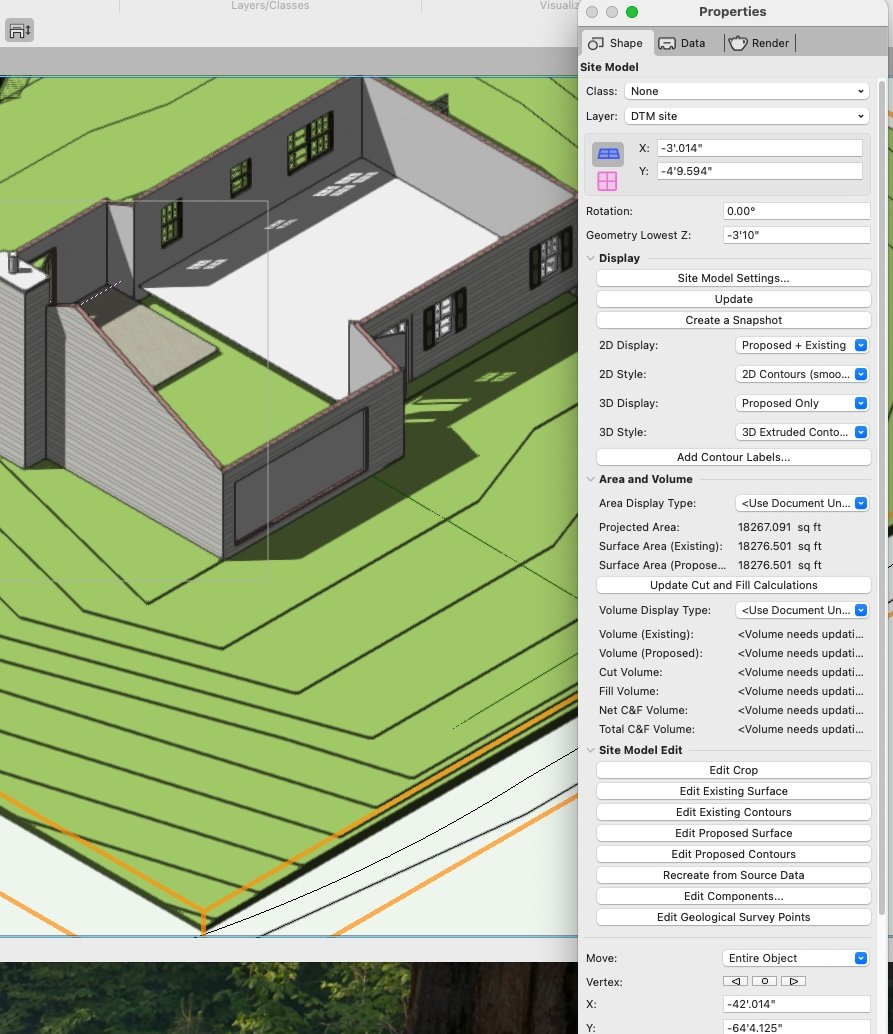

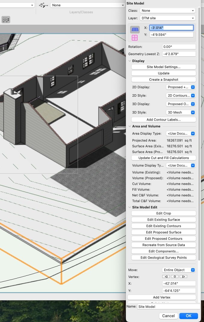

  13. I have a CAD model of a church and 6 acre site that started 15 years ago. With each new VW update, I have updated the same file, and now the file is updated to VW 2024. I have the same DTM (now updated to VW 2024) but now I notice that when I make even very simple changes to a texture bed or other site modifiers that the 'update' of the site model DTM might take 15 minutes or more. I can only watch a spinning beach ball for so long without irritation. Is there some way I can analyze the DTM and find out why it takes so long to update ? or rebuild it or do something to fix this issue ? Would help if I took the time to draw a brand new DTM and copied all the site modifiers over to the new DTM ? (redrawing all the site modifiers is not something I want to spend a lot of time doing). The update takes a long time if I'm viewing in any mode ... including wireframe or shaded, or top/plan. I am running VW 2024 on a new M4 Mac Mini with Mac OS Sequoia. The entire file size is about 250 Mb. It is a very detailed 3D model for making 3D images, including signage, statues, 250 lights, and nearly every detail of the existing building.
  14. Jeff: thanks for tidbit ... but can you be more specific..... do you mean adding a google earth satellite image as a texture to the DTM, then turning it off? One attempt I made to fix this had partial success. I exported the file from VW 2024 into VW 2021. I ran it on an older Mac High Sierra. Then I saved it, then opened it on my newer Mac in VW 2024. It allowed the site model to return to the green color instead of the gray, but still has the same texture bed issue. At least now I can control the site model overall texture (grass, sand, asphalt, etc ....) Since I can see the texture beds using "3D Mesh" I'll just push through this annoyance (but still hope VW will fix it for VW 2024). I like using the '3D extruded contours' because I can more easily see the slopes and elevation changes.
  15. thanks for saving me time from tearing my hair out about this ... I always figure when something doesn't work, it must be my fault. However ... you said that you filed a "Jira" and it might be fixed ... but I'm running a perpetual license with VW 2024. Will this be fixed for VW 2024, or only VW 2025 ? (I am running update 8 for VW 2024). Does this problem exist in VW 2023 ? in VW 2022 ? I skipped a few versions when I updated to VW 2024. Can I assume that I can download these older version if I must ?
