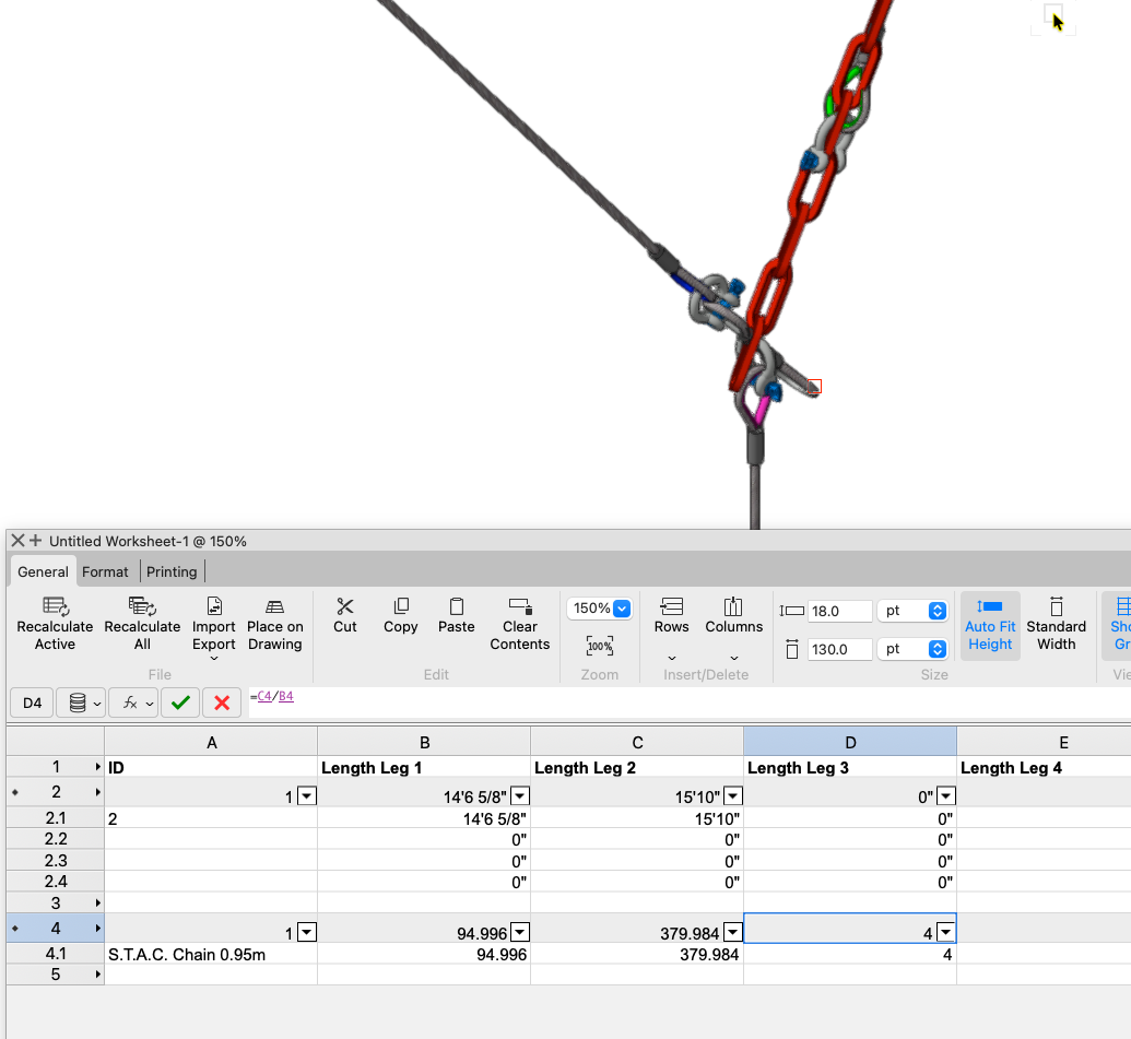

Making this easier is on my list of future improvements. Until then, here's a file with a worksheet to play with. The number of links is calculated using the delta lengths you mentioned. Good idea. Thanks to @Nikolay Zhelyazkov for his help. Links worksheet.vwx

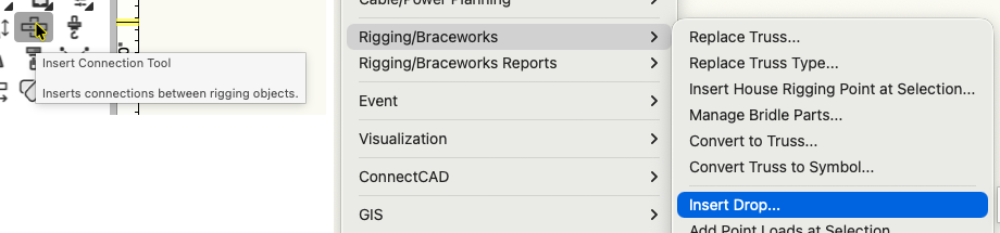

Have you played either the Insert Connection Tool or the Insert Drop menu command? Explore these two options.

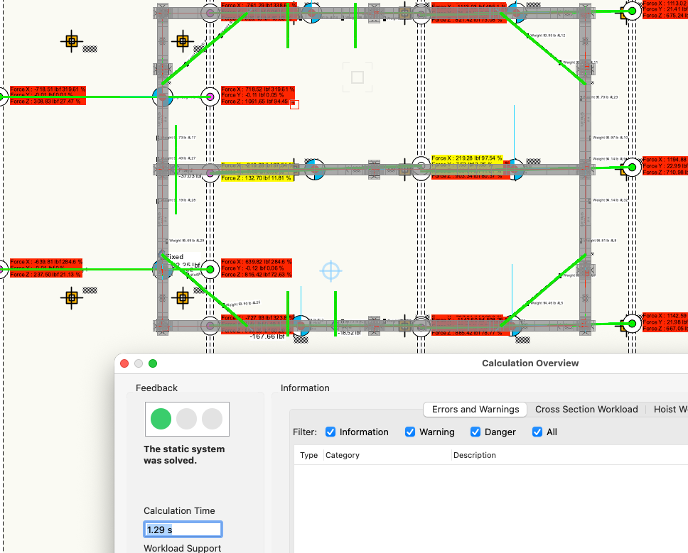

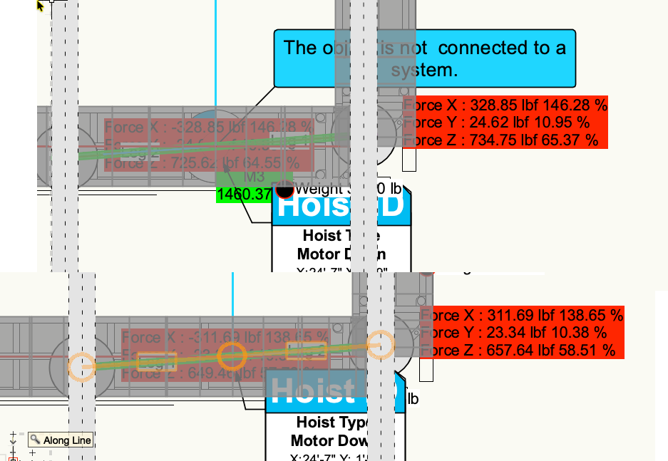

Something Seems Off with Bridles in Braceworks
Scott C. Parker replied to Brian K's topic in Entertainment
Since your system is calculating properly, you can ignore the alerts here. We have a known issue where this particular alert shows up when replacing the downleg with a hoist. If you want to test, replace one of the bridle/hoists with a bridle/downleg instead and run the calculation. You'll see the alert is gone, and the system calculates the same, but for the hoist info. -
Some items just needed a little shifting to have them be seen as connected. Matthew's file was very helpful. I took it a bit further and found more items that were not connected properly. A nudge here, a shift there, a couple of re-drawn bridles, and we're able the calculate the system. It's showing a lot of red, but I don't know the load limits of your overhead beams. Bridles_BK (2).vwx
Thanks for the file. These are all items we're working on.

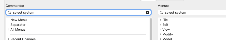

I don't think this is an actual menu command vs. a right-click on object command. Though many objects support standard menu commands when right-clicking, some perimetric tools offer additional tools when the object is selected. Truss and rigging systems are one and offer the Select System Objects option. Have you found a way to see this command in a normal menu? I've searched and not found it. What to do? I suggest a script that can be added as a menu item, thus allowing a keyboard shortcut. Which, in turn, can then be added to the Streamdeck. If you post your query here, https://forum.vectorworks.net/index.php?/forum/9-sdk/, you'll likely receive suggestions.

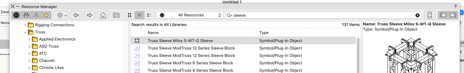

In a design layer, place a truss, select it, right-click on the selected truss, then choose Customize Truss Symbol Data...
So I can try, what truss symbols are you using?

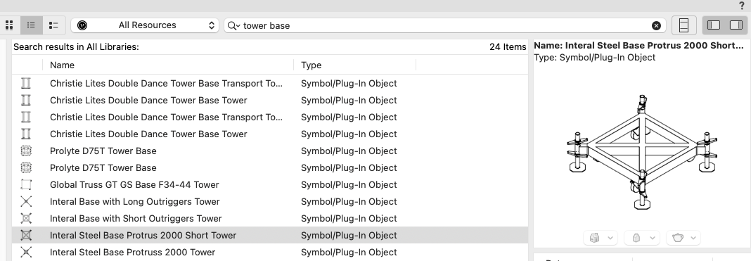

Here's one of my test files that should prove helpful. I've put the stinger (steel) in the top bar symbol on one wall. In the other, I've used the stinger as a pickup symbol on the truss. Top Bar with Stingers.vwx
