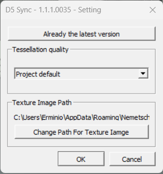

Thank you for linking me that page rDesign! I didn't mention that setting in previous posts Yes it's related, but weird thing is that I always get only the option Project default Pop up menu lets me choose tessellation quality, but always goes back to default and things don't change at all after syncing Same to someone else? If so it could be related only to Ita localization -

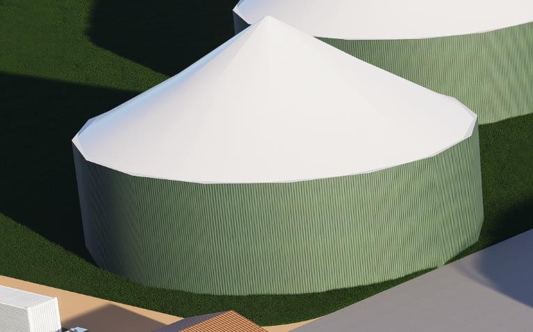

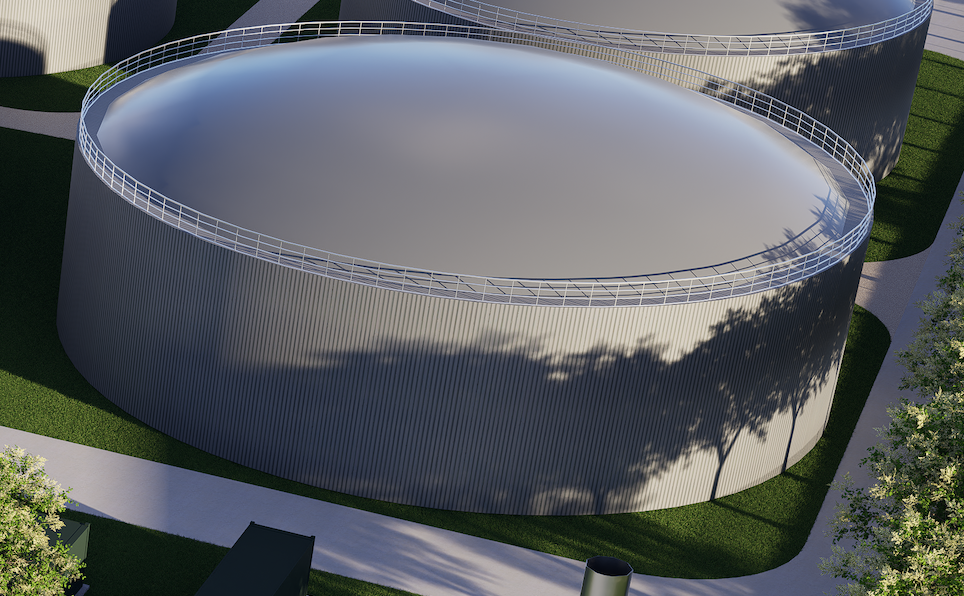

Update I have been able to smooth those extruded circles, by redrawing them from scratch Maybe this has forced the regen of the mesh in D5, don't know Anyway assigning a texture exception causes again the decay of the solid Being inside a symbol or not doesn't seem to affect the result Couldn't get a solution for other primitives like generic solid, NURBS surfaces, unions and substraction (see the dome) -
D5 Render live sync of curved 3D models becoming faceted
erminio posted a question in Troubleshooting
Hi guys Hope this is the right place to post my issue I'm working in live sync with VW and D5 t build a model I've the last version both of VW and D5 Also the lve sync plugin is updated I encounter strange behaviour with very simple curved model Extruded circles are initially well read by D5, being smoothed Then in particular situations that I can't isolate, they become strongly faceted, becoming 16 sides polygons, no matter setting the highest 2D and 3D resolutions in VW preferences For example, assigning a texture exception to the extrusion immediately causes a cylinder decay in D5 Removing the exception generally, restoree the initial smoothness, but not always Generic solid, NURBS surfaces, unions and substraction are also affected Converting them in meshes doesn't solve the problem, since they lose UV properties In the attached file you can see in D5 an extrusion in green and a generic solid in white In VW they are smoothed Does anyone has encountered this problem? ANy suggestion about? Thank you for your time -
