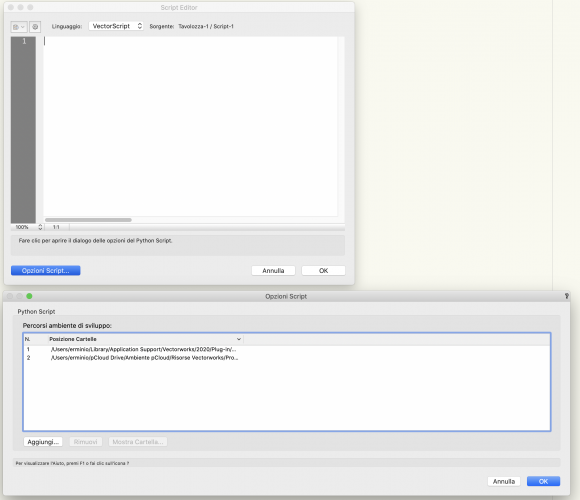

I had the same problem You have to add the path file into the "Script Options..." dialog Is that what you meant twk?
