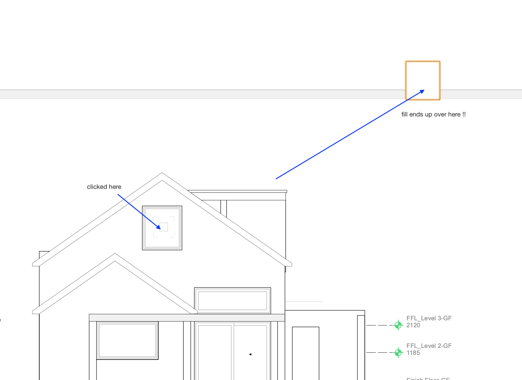

anyone else having this issue : in an annotation viewport and I want to use the polygon bucket fill - if I click to fill the window area (see below) the fill is put up and right instead of in window? ( I seem to remember this happened before in another release)
the old restart the computer seems to have solved it - sorry folks! @cberg - must change my info as I'm on Mac OS 26
