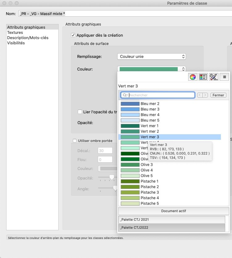

To explain briefly, when i do the migration from 2021 to 2022, all the color of my palette are not the same anymore in 2022. It's like they get less shiny :). Anyway RGB code change during migration (botly or manually done) (CMYK not?) and (as expected) i loose the name of the color i give in the past when i go back into the config menu of a class or a ressource (and when my color palette is selected the scrolling view). What i'm not please.

Printscreen n°2 : State of the color code in VW 2021, already selected when i scroll down the menu. > My RGB definition
Printscreen n°3 : State of the color code in VW 2022, color i had to select manually because not recognized anymore. >> RGB changed but CMYK not?
Printscreen n°5 : State of the color code in VW 2022 after i create a new palette and recover the color from the "document color palette". >>> RGB is the same but CMYK not?
