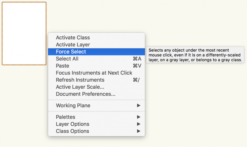

Right-click on one of the edges of the object and then choose force-select. This will automatically activate the layer and class that the object is located on.

I have found and activated force select but active only does not show it or the other plant objects...

The force select has allowed me to move everything but the phantom symbole off of the page. I'm still unable to grab it
