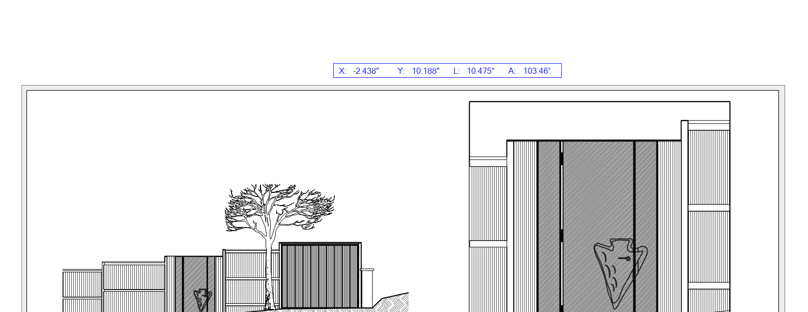

hollister design Studio Posted April 24, 2023 Share Posted April 24, 2023 screen grab of the File menu: VW let's me draw new polygons - but not delete anything. I can move things around - but no undo. Create a blank file - but not open an existing file. Right-click doesn't work. Won't let me save work so I can restart. Second time this has happened today. Thoughts? Quote Link to comment
0 hollister design Studio Posted April 25, 2023 Author Share Posted April 25, 2023 Additional info - when this happens the 'data entry box' (not sure of the correct term) that appears when a tool is in use is getting 'stuck' on even with no tool active. Quote Link to comment

0 hollister design Studio Posted April 25, 2023 Author Share Posted April 25, 2023 I moved everything to a new file hoping it was something with that file, but I will look for that if it happens again. I couldn't open any other files will the issue was happening to test - but I could create a blank file and they were affected also. It happened about 10 time yesterday, once in the morning, twice after lunch and then with increasing frequency until I just quit for the day. It's odd because many tool worked fine - polygon, circle, rectangle - but no 'higher functions' worked. Quote Link to comment

0 hollister design Studio Posted April 26, 2023 Author Share Posted April 26, 2023 Just started up again after a day of behaving normally There is definitely something like a tool is stuck open - but there isn't a window open on or off screen. The windows 11 task bar shows a second instance of VW that is just the "data entry box" by itself - this is not normal. This 'data entry box' shows X,Y, L and Angle although there is no tool selected. If I use a basic tool (the only functions that work seem to be basic geometry) the "data entry box" changes to that tools default. Again, most menu items are greyed out. There is no way to get out of this except by restarting. Vector works is 2023 SP4 build 693289 Quote Link to comment

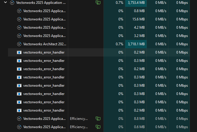

0 CSzymberski Posted February 14 Share Posted February 14 I had the same problem just recently, with a fair amount of work done since the last save and auto-save. I also had that separate and floating data entry box. I opened Task Manager to see what VWX was doing. Usually, there are (2) subtasks open for VWX. This time there were (3). As I could not close the data entry box manually, by clicking on the 'X' in the top right corner of its window. I forced closed the smallest subtask in Task Manager. After a few thoughtful seconds, it closed and I was able to save my work. I have never had this occur, and must admit that I found it confounding at first. Hopefully, it doesn't happen again. 1 Quote Link to comment

0 CBST Posted May 9 Share Posted May 9 (edited) Found this thread just now while experiencing the same issue. Has anyone found a solution that doesn't involve forcing processes to stop via the task manager? The frequency with which bugs and glitches like this occur is concerning to say the least. Using the latest VW 2025 update. Attached image is what I see in the task manager. Feels like a gamble to close any of these. Edited May 9 by CBST Added screenshot Quote Link to comment
