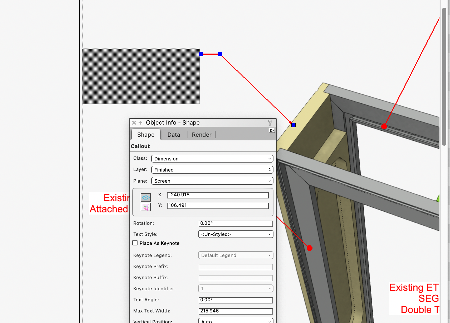

Text boxes showing up as Black filled rectangles
Elite Exhibits replied to gangotti's question in Troubleshooting
@gangotti Another possible source of this Black Text Box aggravation is Unified VIew Attached is from a edit done today Single Design Layer drawing No Sheet Layers No Viewports Callout Text Set To Class Attributes Zoom in / Zoom Out sometimes restores the text visually to as expected Turning Off Unified View appears to be the requirement if there are several Callouts Blacked Out In our experience, Unified View creates many similar anomalies Peter -
