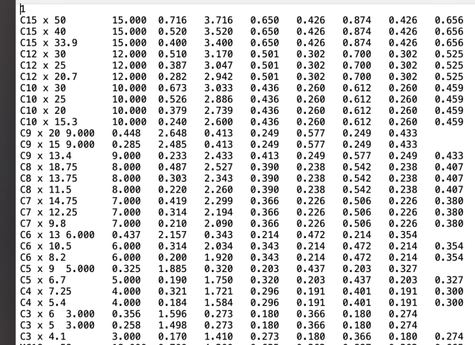

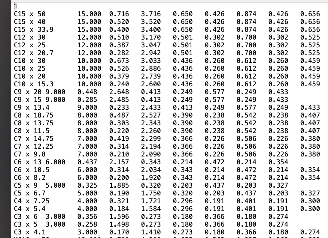

Looking at the text file, it would be helpful to understand what the headers signify. Very helpful. I can muddle through.... I will break out the Steel Manual and compare the data to the numbers. I am sure something refers to height, depth, web thickness, and the radii of the profile edges. I will tread carefully lest I break, and report back. Channel-Inch.txt

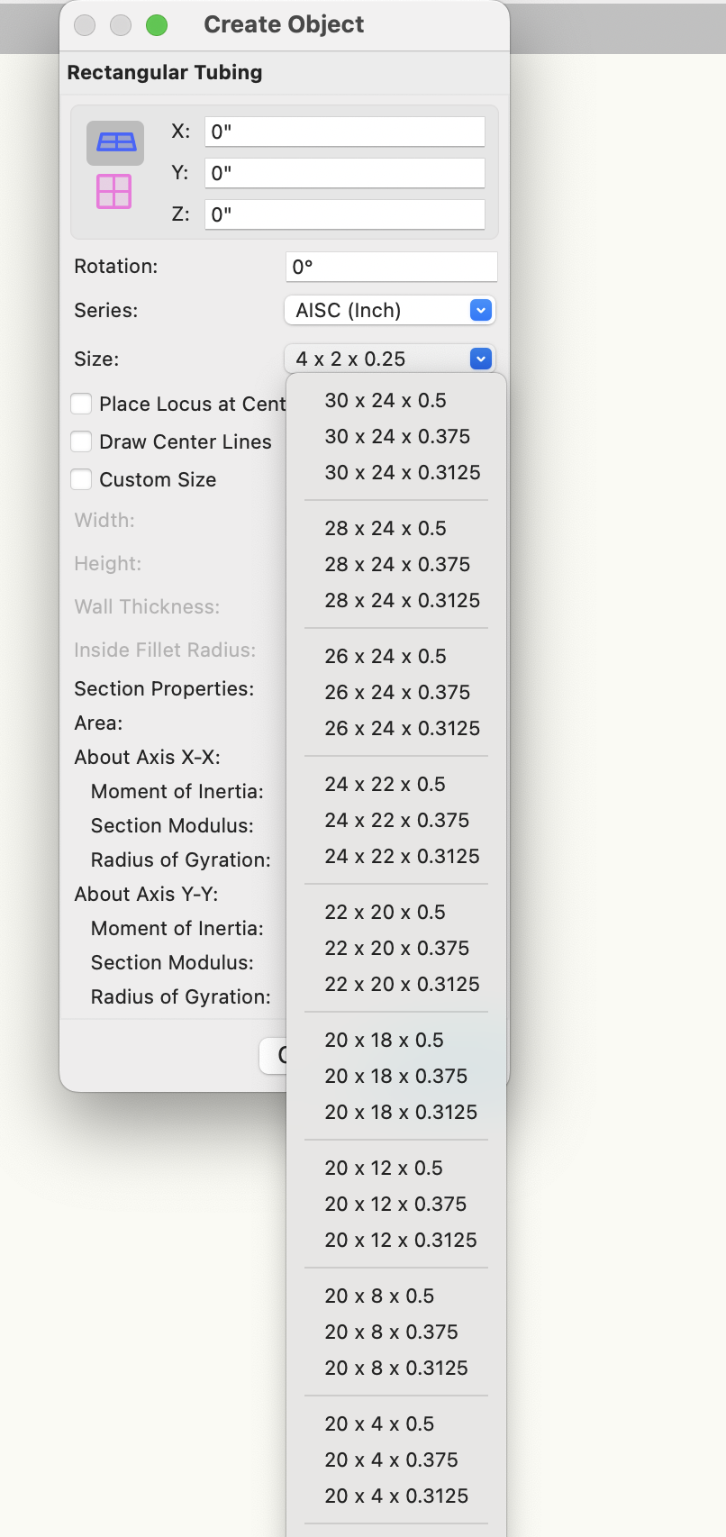

I can add a custom profile to framing members/structural members by creating a symbol. It would be nice if the default library of steel shapes could be supplemented/customized. Many commercially available shapes are not listed in the VW pulldown menu. For example, a 1" x 5/8" x 1/8" steel angle does not show up as a default option; nor does a 1" x 1" x 1/8" Tee. I can name a dozen others. Architectural aluminum (square edge) profiles would also be nice. As would non-metric zees. (I know.... we are living in the dark ages here...) The default steel shapes appear hidden somewhere, which is atypical of how things usually work in Vectorworks. I wondered whether the list of standard shapes can be found and edited. Ideally, custom steel/metal shapes would exist in a fingerprinted file like custom door leaves, making them a user library resource that is transferrable from file to file. C.
Is there a way to add custom steel sections/profiles to the library of standard steel shapes?
