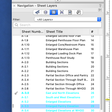

cberg Posted May 10, 2020 Share Posted May 10, 2020 Is there any way to change the default color of items that are checked out by a user during project sharing? It is nearly impossible to read the CYAN color. Quote Link to comment
Hans-Olav Posted May 11, 2020 Share Posted May 11, 2020 I haven't tried but if you change the color of the user in the Project sharing setting, will the color of the text update to the same? Quote Link to comment
cberg Posted May 11, 2020 Author Share Posted May 11, 2020 I don't think that is what controls the color of the checked out sheets and layers. At present my user color is green and checked out items are cyan. Any other ideas? For anyone older than 35, VW is really hard on the eyes. It is practically impossible to read cyan text on a white background. If you have a bunch of sheets checked out, it's hard to see which one is which. Quote Link to comment
Guest Tolu Posted May 20, 2020 Share Posted May 20, 2020 Hi @cberg, I agree the cyan color is almost unreadable. Could you please confirm the version of Vectorworks you are using? The color was corrected in Vectorworks 2020 SP3. Quote Link to comment
cberg Posted May 20, 2020 Author Share Posted May 20, 2020 (edited) I was using 2020 SP2.2 We are working on a few big deadlines and I did not want to update until we got our sets out. Just downloaded 2020 SP 3.1and the blue is now readable. Vastly better. Thanks. Edited May 20, 2020 by cberg Quote Link to comment
