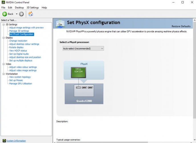

Hi Tom , I'm not sure I am answering this as I am no techie but I do know I have an nvidea K2000 graphics card (not the original internal pc graphics card) and that it is possible to check which card is being used in the graphics card control panel. See attached. Hope this helps. David

Thanks @JimW I dont really know what I'm talking about tbh. Quite bizarre but for 4 months I was unable to view my Nvidea PhysX control panel due to a windows upgrade, but this morning for the first time in a while I was able to access it to ensure my pc is using the correct Graphics card!

You know more than you may think! The PhysX selection on it's own usually wont do it, but often setting both that AND under Manage 3D Settings, set the Global preferred graphics processor to the eGPU. Sometimes if I only set the preferred GPU it didnt work, but setting both did the trick.
