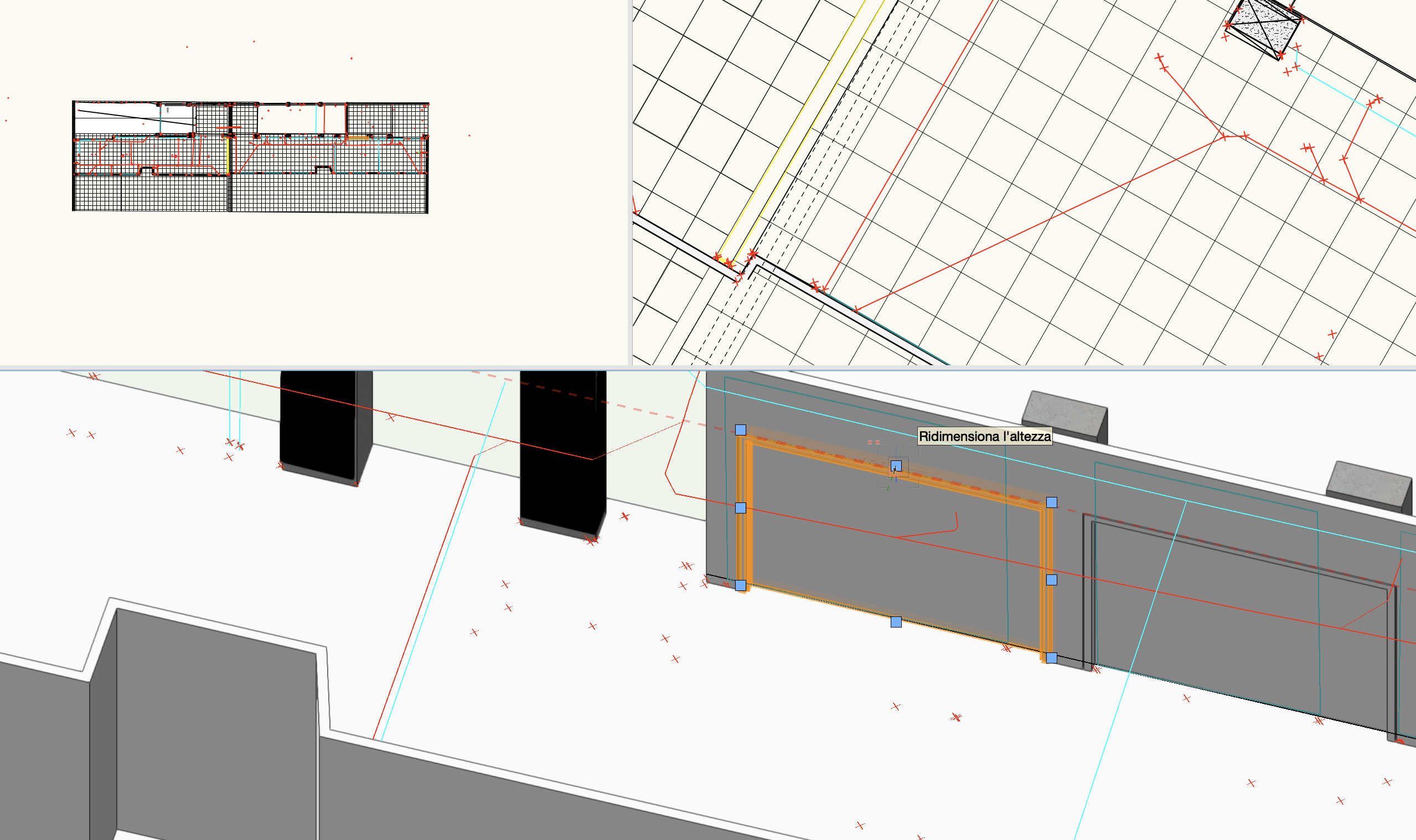

So, found out that the crash is related to the fact that the arrow tool had the inwall option enabled that therefore let the door be accidentaly dragged out of the belonging wall. This causes VW2025 to start beach balling. Hope this crash may be fixed soon. -

I've tried to perform the very same action on my MacBook Pro (M1 Pro 16GB sonoma 14.7) and was able to reproduce the very same beachball freeze of Vectorworks 2025. Attached the vwx file condominio_via A Ricci-Foggia_v25.vwx -

noticed that it somehow happens even trying to move the same kind of door in the wall. Resizing the door via the OIP goes ok. -
When resizing in 3d view by dragging the center top handle of a Door Garage Single Flush placed in a wall, Vectorworks starts beachballing endless. So I have to force quit (waited overnight). Happened two times in sequence. Attached the crashlog. VW2025 architect ita update 2.1 R1 (build 788841) MacMini M1 16GB Sonoma 14.7.1 crashreportVW25-.rtf
