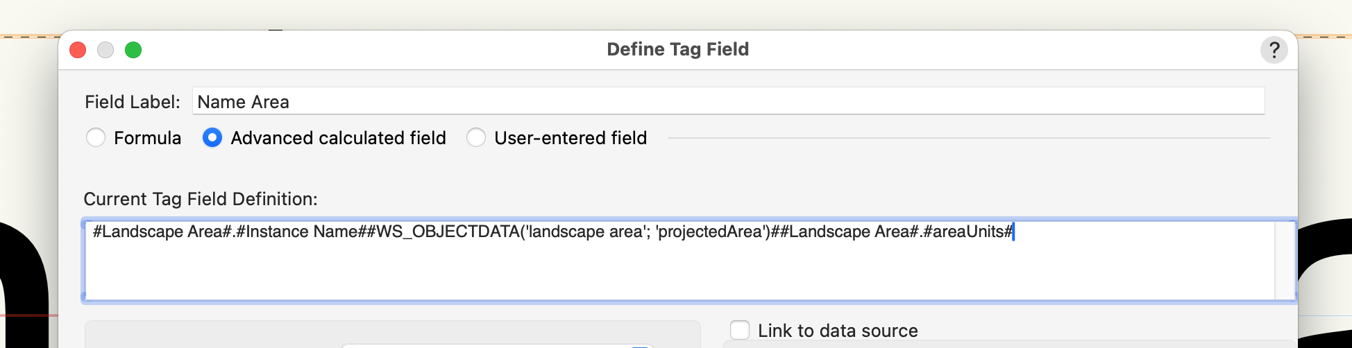

Changing to a comma definitely does something but doesn't correct the issue. See right side of screenshot. I am happy to keep fiddling with it as an exercise in OCD therapy but the solution above resolves the immediate issue.
Update: No success with this formula but this one works: #Landscape Area#.#Instance Name##AREA##Landscape Area#.#areaUnits# #AREA# from Object Function data source
Ok, thank you! EDIT: @Alexandra Beshevlieva When I change the parameters per your instructions it simply removes the name and projected area altogether. What am I missing? Typically I use the "Define Tag Field..." dialog via "Edit Object Style..."→"Edit Tag Layout" and the accompanying drop-down options. In this case I copy-pasted your parameters into the field definition box.

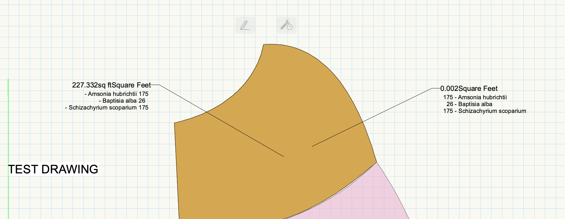

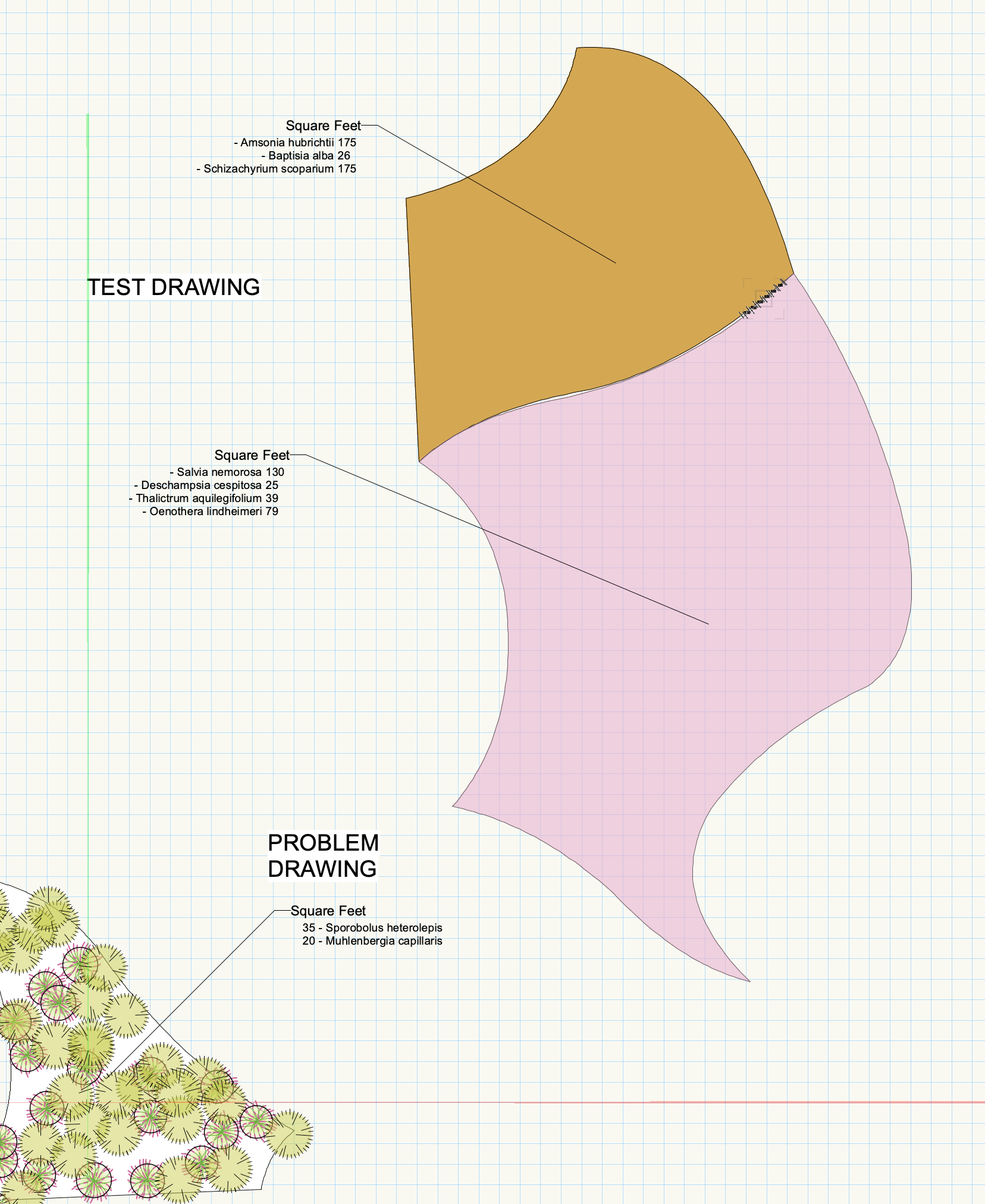

Having an issue with data tags after migrating from v2022 to v2025 where some tags are inconsistently calling metric data to as opposed to imperial as specified in document settings. The screenshot below shows two LAs from a test drawing with the same data tag called from the RM of the problem drawing. One is showing feet & inches correctly, the other displays the projected area in mm2. If I change the settings of the correct LA in any way, the tag reverts to the metric area. It is unclear to me the source of the issue. I've seen a similar issue here. Reprex attached. Cheers PWF 2025-09-15_reprex_dataTag-metric.vwx
