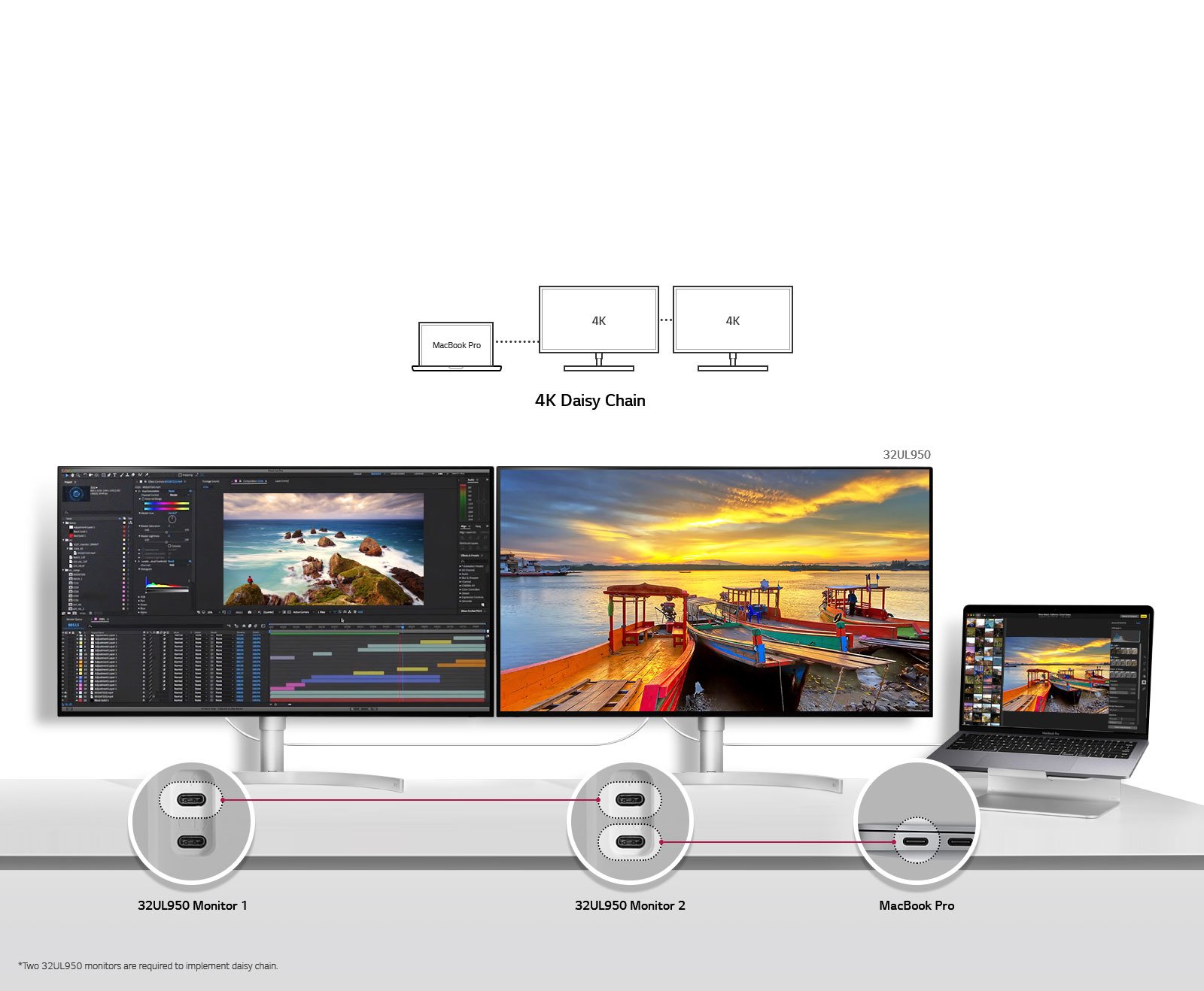

PeterYip Posted March 1, 2020 Share Posted March 1, 2020 @Andrew Davies I have an idea, depends on which LG monitor you have, some do support daisy chain USB-C, so you could still plug your mac into 1 USB-C, and the other one to the 1st external monitor, and connect your 2nd external monitor to your first. Otherwise, there are HDMI>USB-C cable which should also work. Quote Link to comment
RonMan Posted March 1, 2020 Share Posted March 1, 2020 In daisy chain mode, as shown, the Mac GPU would be hard pressed to keep up. If the daisy chain has the eGPU before the MacBook, you would get all gate benefits of the eGPU. I think that is the ideal configuration. If you can't daily chain, there is a way to make the eGPU primary in System Preferences. Go to Displays/ Arrangement and make sure the menu bar is on the display from the eGPU. You won't need to change the setting in Get Info. When you use the system by itself, the internal GPU will take over, but whenever you use the eGPU, you will get the eGPU performance by default. The only time I use the internal GPU is when I am traveling. Otherwise, I drive everything from the Radeon Pro WX7100. Here are some test results Using GeekBench 5.01, OpenCL test 40,336 AMD Radeon Pro WX 7100 Compute Engine, eGPU 13141 AMD Radeon Pro 560X Compute Engine, internal Using GeekBench 5.01, Metal test 45,878 Radeon Pro WX 7100 Compute Engine, eGPU 14,031 AMD Radeon Pro 560X Compute Engine, internal The difference is easy to see when using VW. Both monitors are Dell UP2716D models. They have excellent color. The resolutions are 2560 x1440. There is an equivalent 4K model. Of course it costs more. I think that is all I have. Forgive and spelling for grammar errors. I slapped this together in just a few minutes. I did run the GeekBench tests again for this. 1 Quote Link to comment
Andrew Davies Posted March 1, 2020 Author Share Posted March 1, 2020 Hi again - So helpful - thank you!!! @PeterYip Tried both of those with no success I am afraid. I seems the LG 5k only has one TB 3 input and the remaining USB-C sockets are just USB. Also tried the HDMI to USB-C adapter route with no success. Will probably wait until there is a GPU card which I can install in a eGPU which has at least 2 x TB 3 outputs. My only other choice is to put the whole thing on eBay and buy a couple of Displayport monitors. Again - the Blackmagic eGPU doesn't give great graphics performance. @RonMan I do a lot of Skype calls - do your monitors have a webcam? In fact - how can you do USB Webcams / Mics / Speakers with an eGPU? 🤯🤯🤯🤯 Quote Link to comment
