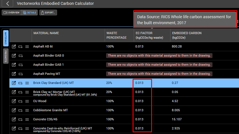

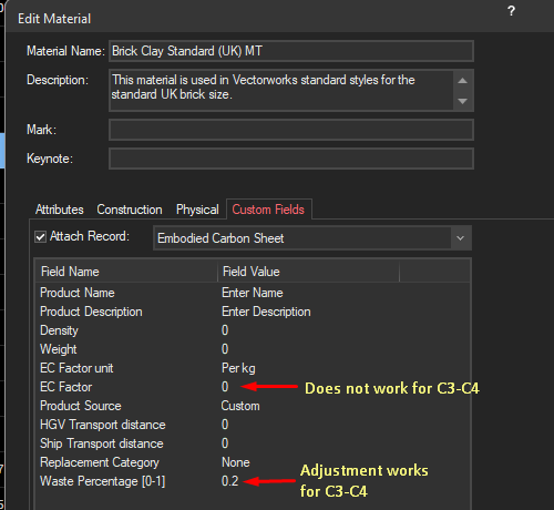

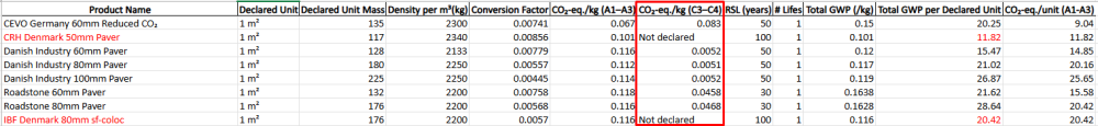

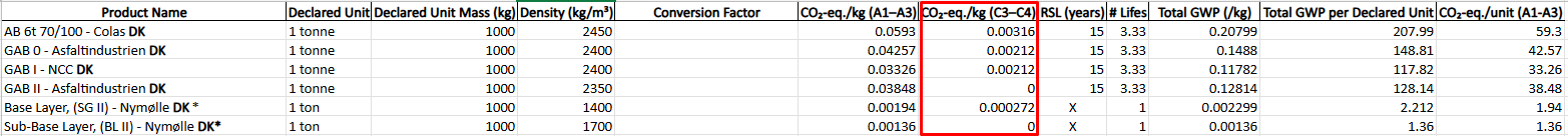

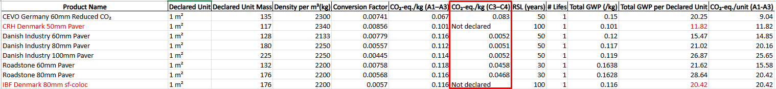

Poot Posted September 26, 2025 Author Share Posted September 26, 2025 On 5/15/2025 at 7:06 PM, Luka Stefanovic said: The good news is that this will be much easier to edit in the next version, with the new and automated Embodied Carbon Calculator coming out as part of the Sustainability Dashboard in Vectorworks 2026. Hi @Luka Stefanovic, I have been taking a look at the new VECC tool through the sustainability dashboard, and have some initial questions on adjusting the C3-C4 values. I am working with specific EPDs, many of which provide C3-C4 data that is different than the standard value from RICS used by the calculator (see below). I have tried adjusting the values by attaching an Embodied Carbon record sheet, but it does not change the EC Factor for these phases. The new interface is a huge improvement! Attaching and adjusting the record seems to change the waste percentage, but not EC factor for C3-C4. Quote Link to comment
Vectorworks, Inc Employee Luka Stefanovic Posted October 10, 2025 Vectorworks, Inc Employee Share Posted October 10, 2025 @Poot Glad you feel like it's a big improvement! Hopefully we can carry on with the good work and continue to make this tool even better! That EC factor in the Record Format is for product stage only, the end of life EC factor can be changed in the settings in the top right corner. Though I'm assuming this won't do what you're after as it will apply another value to all materials. Would you mind sharing one of the EPDs you mention, perhaps this can be one of the next improvements! Quote Link to comment
Poot Posted October 10, 2025 Author Share Posted October 10, 2025 (edited) 2 hours ago, Luka Stefanovic said: @Poot Glad you feel like it's a big improvement! Hopefully we can carry on with the good work and continue to make this tool even better! That EC factor in the Record Format is for product stage only, the end of life EC factor can be changed in the settings in the top right corner. Though I'm assuming this won't do what you're after as it will apply another value to all materials. Would you mind sharing one of the EPDs you mention, perhaps this can be one of the next improvements! Thanks for the input @Luka Stefanovic! Yes, its a big improvement in terms of ease of use compared to the VECC worksheet, and hit many of the points i made last january when comparing with a similar tool for ArchiCAD. Yes, it would be essential to have the flexibility in the 'end of life' (C3+C4) values, since they can vary a lot - and thus have a big impact on the final numbers. I think its a relatively simple fix - just another entry/field for these numbers in material properties or within VECC. Otherwise it makes it difficult to use when those numbers are used to make calculations. Here are some examples showing variation in End of Life (C3-C4 combined). I also attached some EPDs Wood boards: Concrete pavers: Asfalt: Kebony Clear - Norway_NEPD-3659-2604g.pdf AB 6t 70-100 - Colas - Denmark.pdf Edited October 10, 2025 by Poot Quote Link to comment
Poot Posted October 14, 2025 Author Share Posted October 14, 2025 Hi @Luka Stefanovic, Just a question: how likely is there to be an update on that functionality in the near future? I helped build an early phase LCA tool for landscape outside of VW which makes use of 80+ EPD's and was meaning to put all of the data into a template with materials and things like hardscapes within VW to share publicly - which would be useful for many working in Northern Europe/Scandinavia but I can't really do that without the C3-C4 phases since that is a part of most LCA analyses. Everything else in the VECC tool seems to be there (A1-A3, transportation, replacement, etc) - so its a small hurdle. I put a request in wishlist - but thought its worth asking since this is a 'hot topic' - especially in Denmark. Cheers Quote Link to comment
