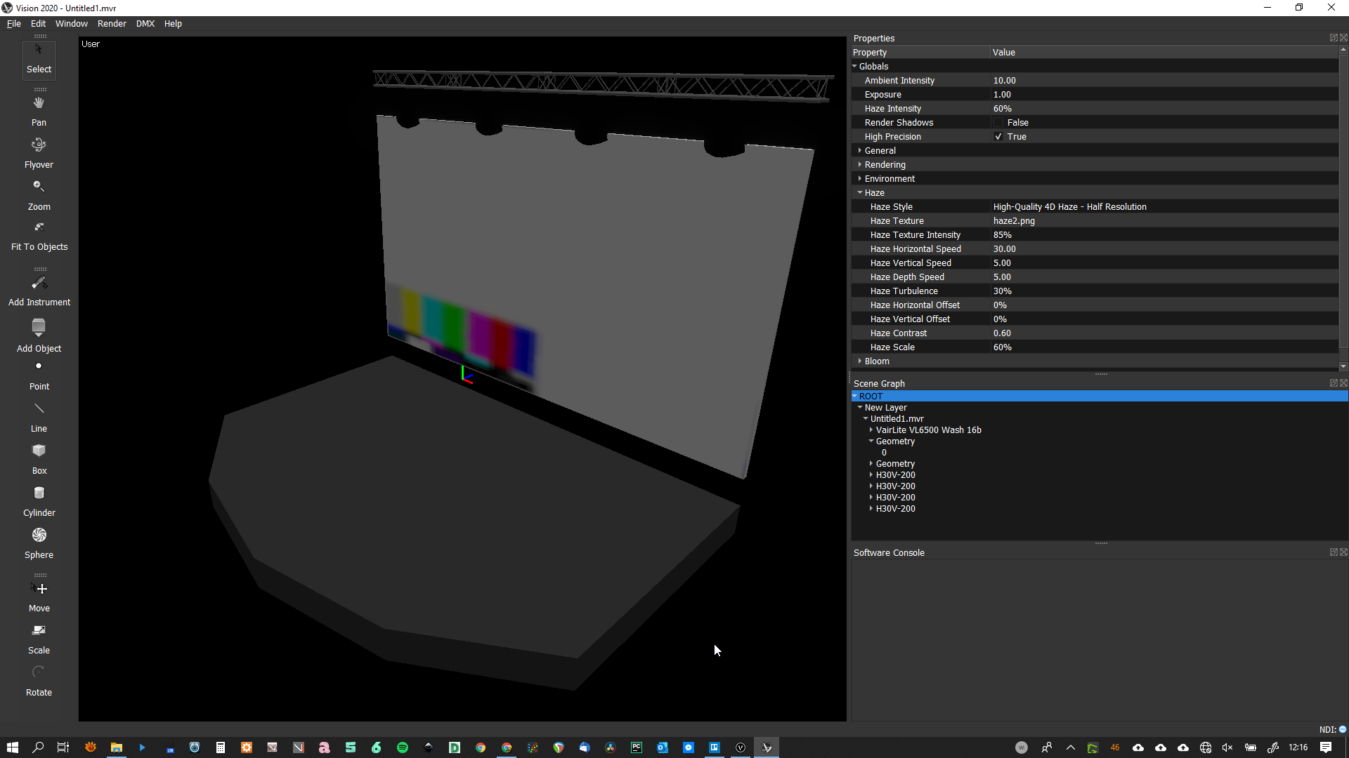

  8. Hi, How change curved geometry quality in MVR export? Look at front stage edge. This is a simple poligon extrusion.
  9. Hi, Why my texture difference beetwen Spotlight and Vision? This is a simple extruded rectangle and MVR export in 2020 SP2
