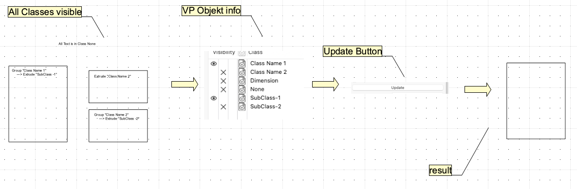

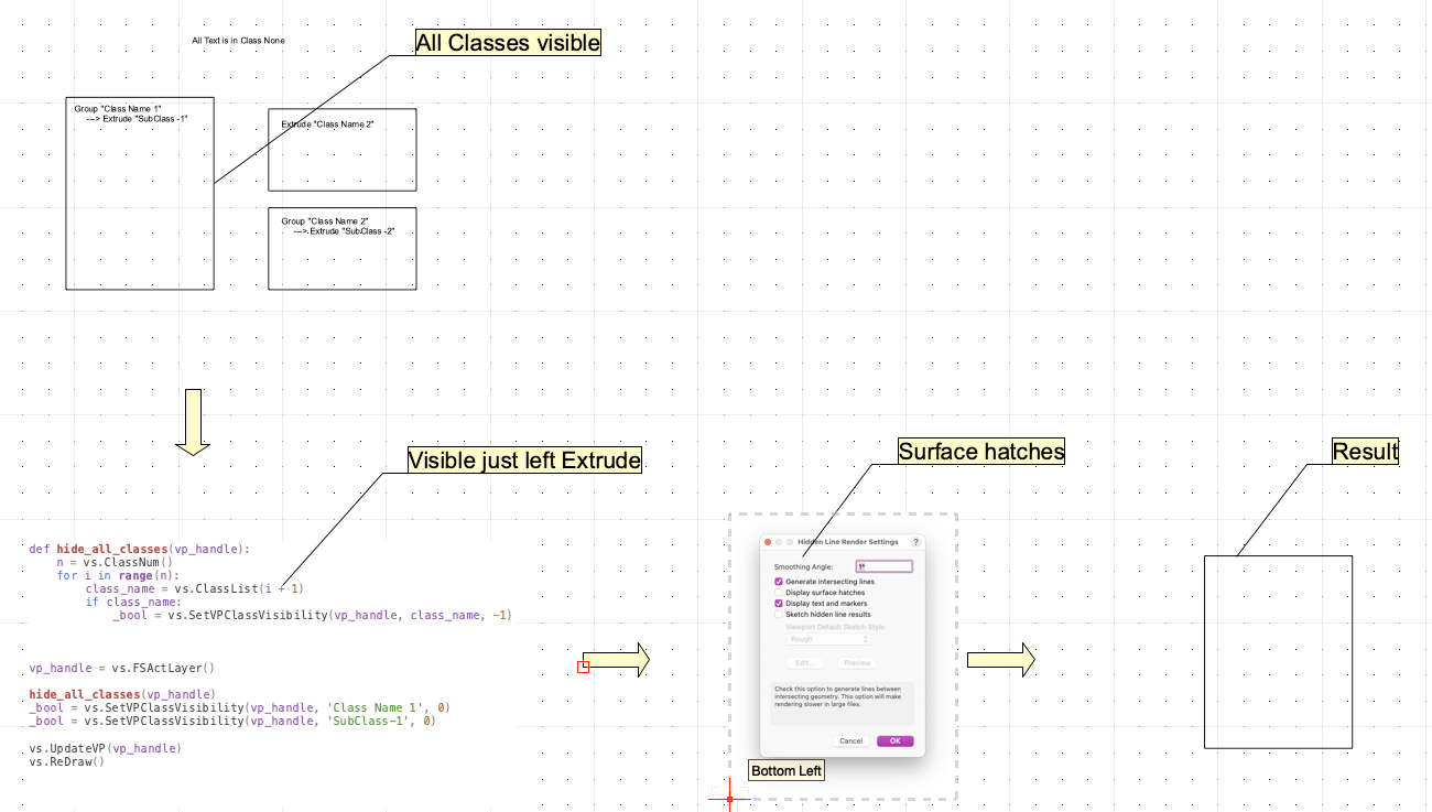

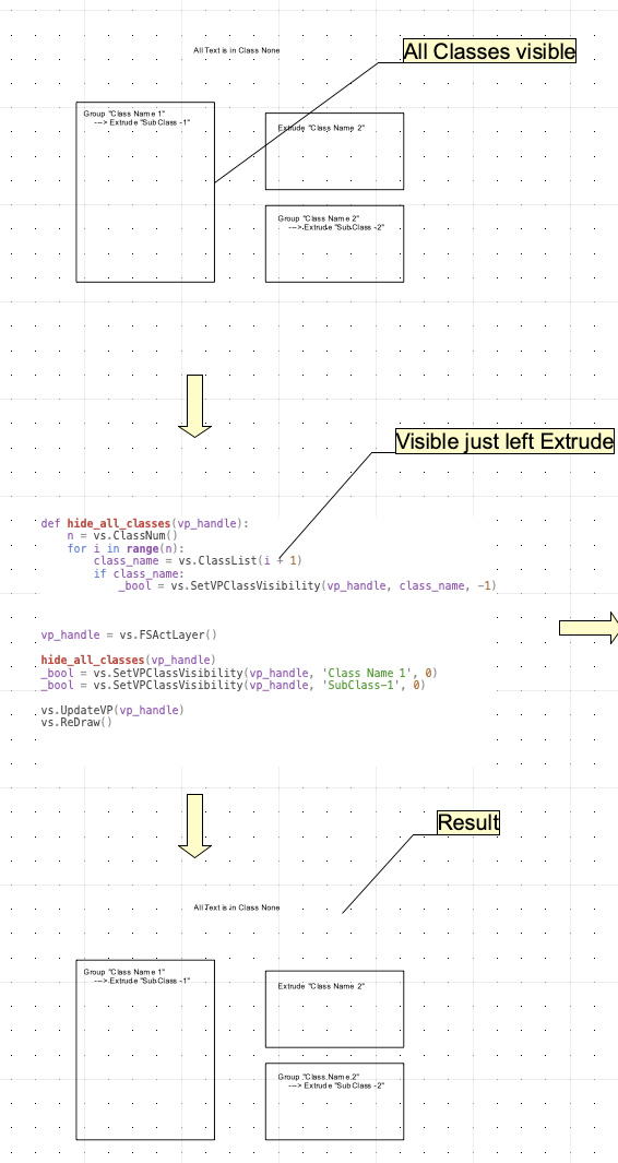

I reduced to a simple test. Creating a viewport from 3 extrudes and switch off the left extrude. Manual Workflow: Workflow with Script: Switching off the Surface hatches the result is correct: Good possible i missed something. Also a possible conflict by combining vs.UpdateVP() and surface hatches option. I will submit a bug. class vp hidden line.vwx -

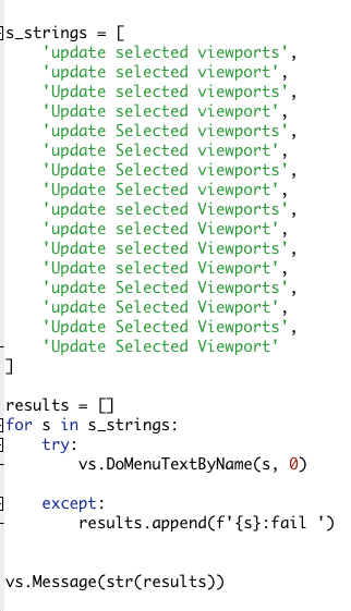

got it. Looked like a typo 🙂 -

BTW, you are right there is not a fundamental difference between the menu-command and the script command. The Menu command would not fix the issue completely. It seems that the button on the info-palette makes the difference. Also Update ALL fixes it. I think the issue sit is a little bit deeper than just an update issue. -

Thanks I tried with, without s, small letters, big letters etc. feel bad by using this one but once i got it with this "brute-force-method" (not in this case) -
