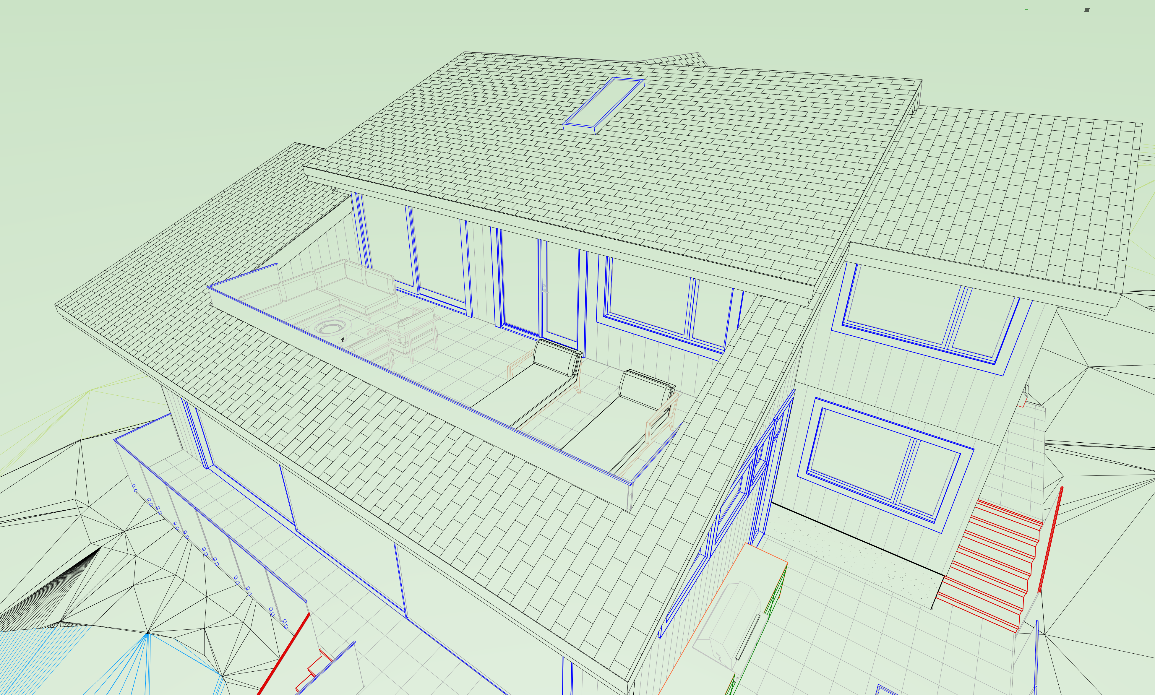

Is there a solution to hatches that sometimes rotate themselves 90deg from the texture when switching from render to hidden lines? And it's not consistent, some align and others don't. See attached shingles...
