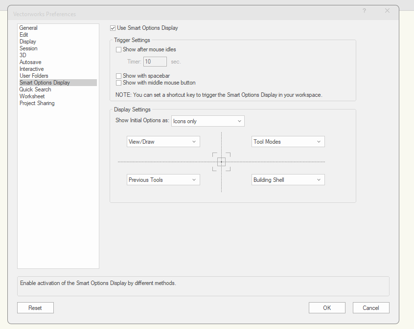

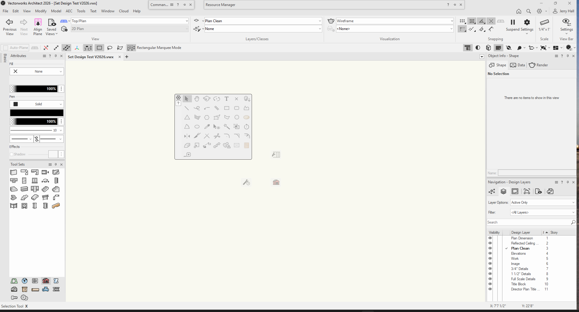

  2. When saving a new file & starting to draw some of the time my Smart Option Tool set is not selectable and is greyed out. But I can move my curser over the Basic Tool Pallet & select the tool & start drawing. I had this happen before & not knowing what I did it suddenly stated working correctly. IS there a new setting in VW 2026 for the Smart Options Display?

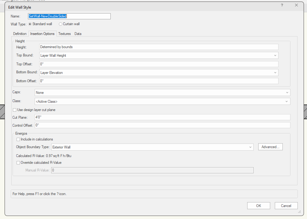

    Thanks Tom, I now see that I have to create an Wall Closure component that is at a height above the selected cut plane, then it is visible the same as VW2025. One other question is in VW2026 help I'm reading the Wall Closure Settings but do not see where this setting is to change. I do use 2 different styled walls each with a core component. But in both I do not see where the Wall Closure Setting in the Edit Wall Style dialog box. Mine does not give this option.

    Thanks very much for letting me know VW changed that setting in 2026, I have never had that option selected in previous version because the majority of my drawings are 2D & never needed that design layer wall ht.. And YES now it looks like my previous walls in plan. And Yes I did not read the Read Me Notes this time.

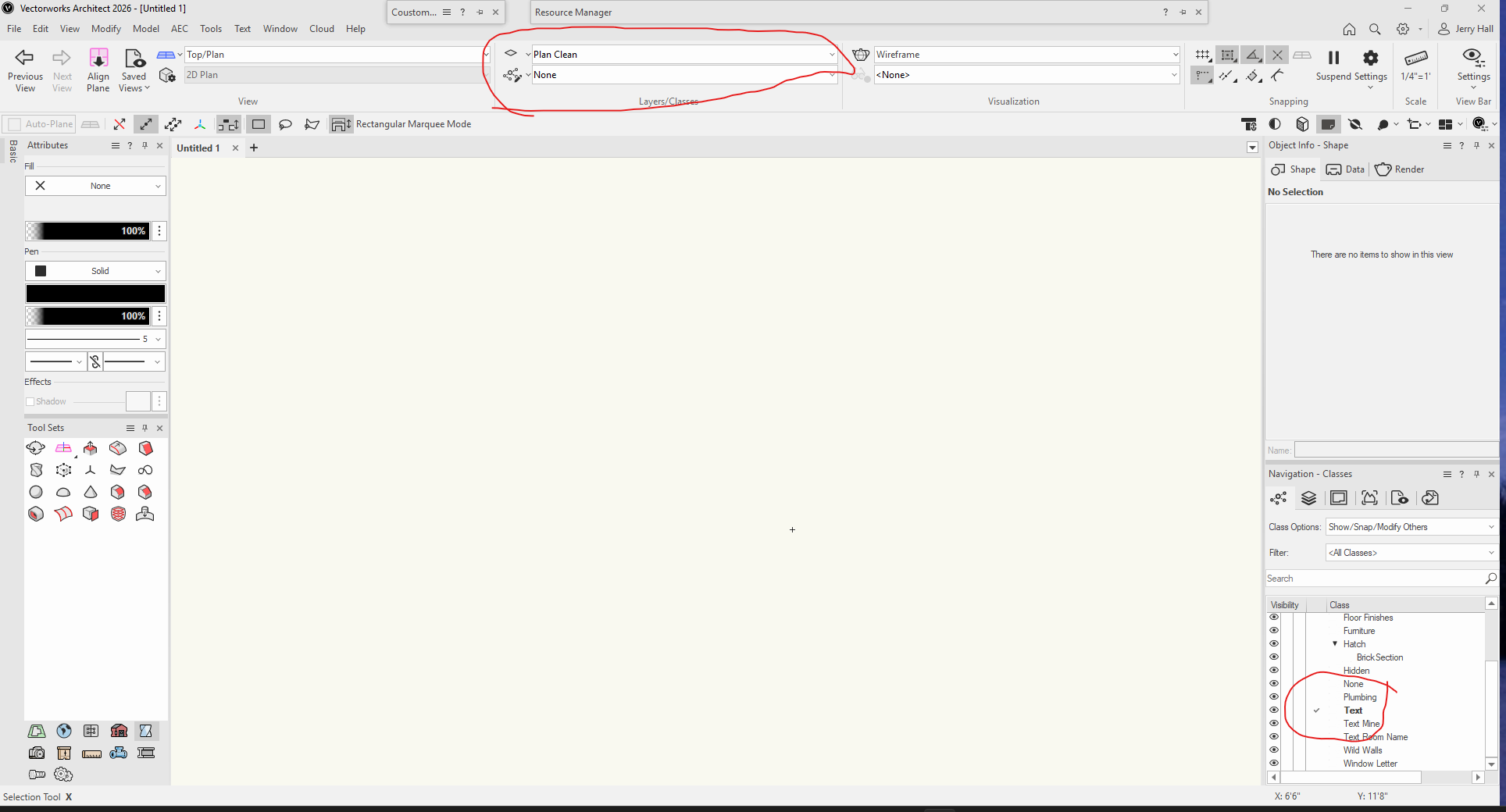

  11. UPDATE in the effort to keep trying things to see if there is a work-around, I've noticed the active class selected is not displayed correctly between the ribbon across the top & the Navigation pallet. When changing the active class in the ribbon above it does not change in the Navigation pallet.
