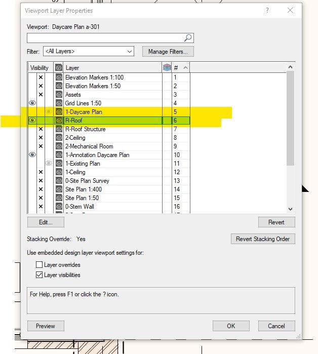

Another option is to create a sheet layer vp and in that viewport change the layer stacking order so that the floor plan is above the roof.  Then set the floor plan layer in the viewport to grey.
