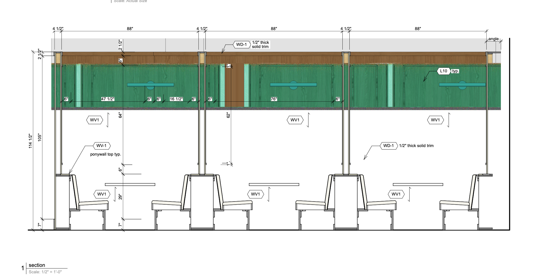

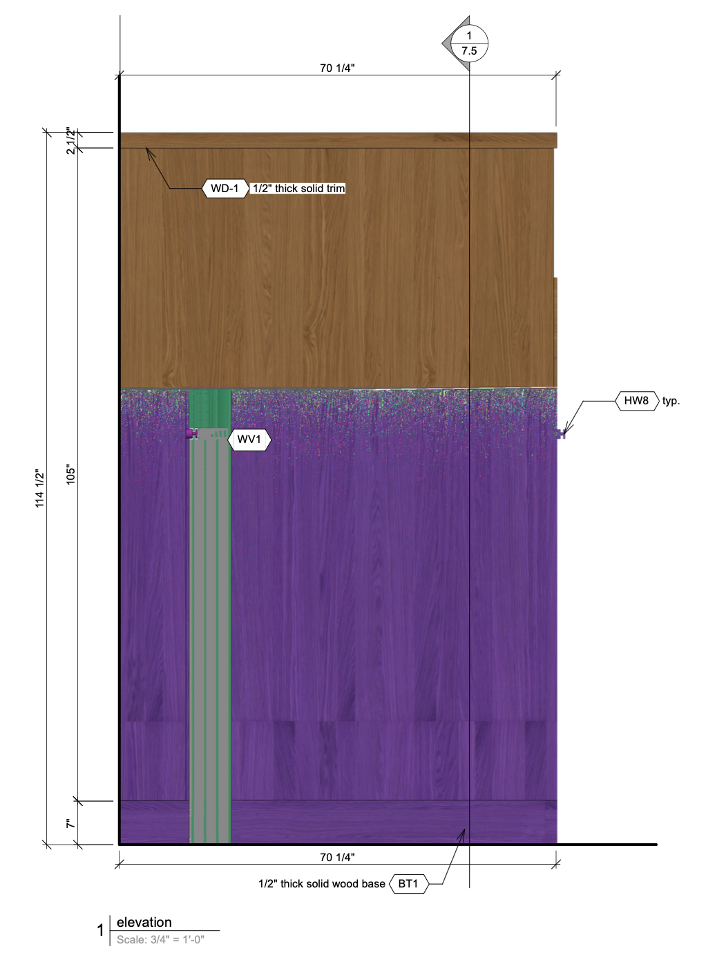

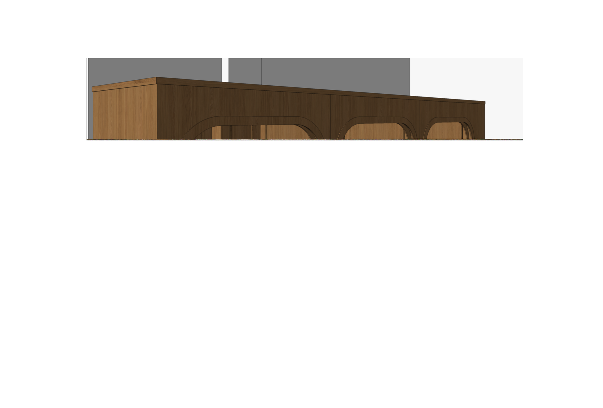

What is up with PDF exports with VW 2025?? I am using the publish command, and all viewports are set to update before exporting, but some of the viewports are only half published, and some result in wacky colours and are partially complete. I have to export 5 or 6 times, and go to each viewport and update manually before it MIGHT work. It happens on multiple files, but not all the time. Anyone else having issues? Some resultant screenshots attached so you can see what I'm getting.

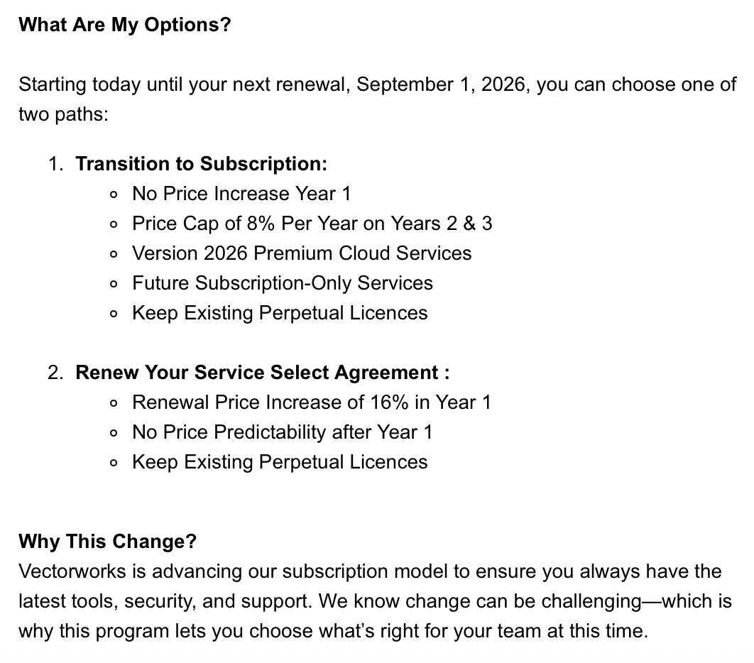

I just got this letter from VW Canada yesterday. It seems that they have had enough of people staying on the service select program, so they're pushing us onto the subscription model. If I read between the lines, it looks like if I don't accept the subscription then the cost of the service select is going to skyrocket. Did anyone else receive this? What have you done?

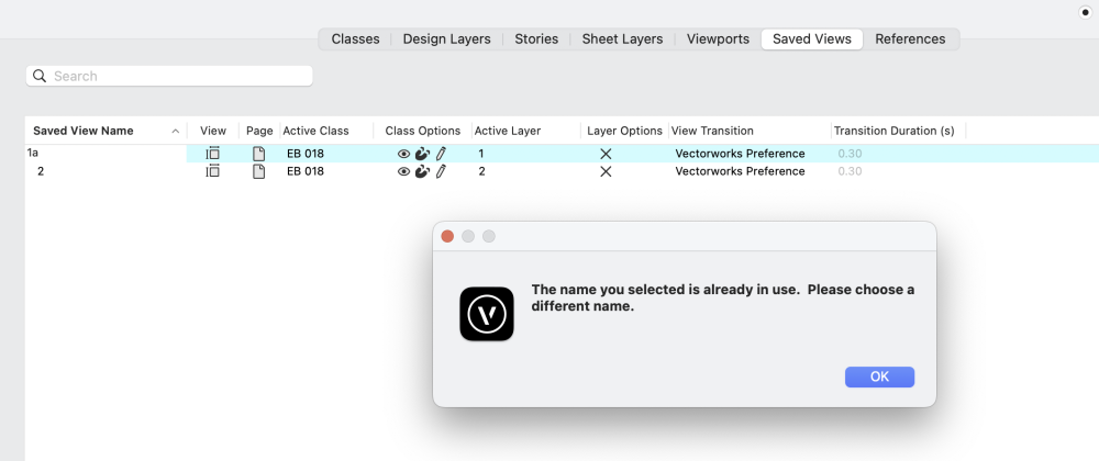

Finally, I've updated to Update 6, and this is now working. Sort of. Many times, but not all, if you publish multiple saved views of design layers to DXF, it doesn't import properly to my CNC software. But if you export each saved view individually with the same settings, it works. Better than nothing. There is also something else odd with saved views. If you try to save a view with the name '1', it says that name is already in use. However there is no saved view with the number '1'. There is however a design layer named '1', but it used to accept the same names for either a saved view or design layer. It seems to only have a problem with the number '1'. I can have a '2' design layer, and a '2' saved view, no problem.

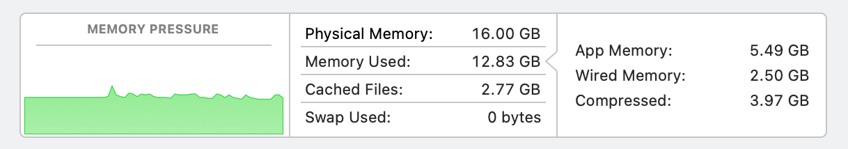

It just doesn't seem like a memory problem. I've been running the computer this way for 2+ years, no issue. Then on Friday it was like a switch flipped, laggy response. Dock icons judder in the up/down movement when opening. Can't type an email or anything into the calculator unless the mouse is moving. Then I figured out that it only happens when VW is open, and a second monitor is running. I could see it if I just did an upgrade or something, but I didn't. I didn't change anything. If it was memory, you would think if I closed down everything except VW, with no file open, there would be enough memory to type something into the calculator. Here is an image of the memory situation, with mail, VW, Safari, preview, and Excel open. I don't usually have more than a couple Safari tabs open. -
