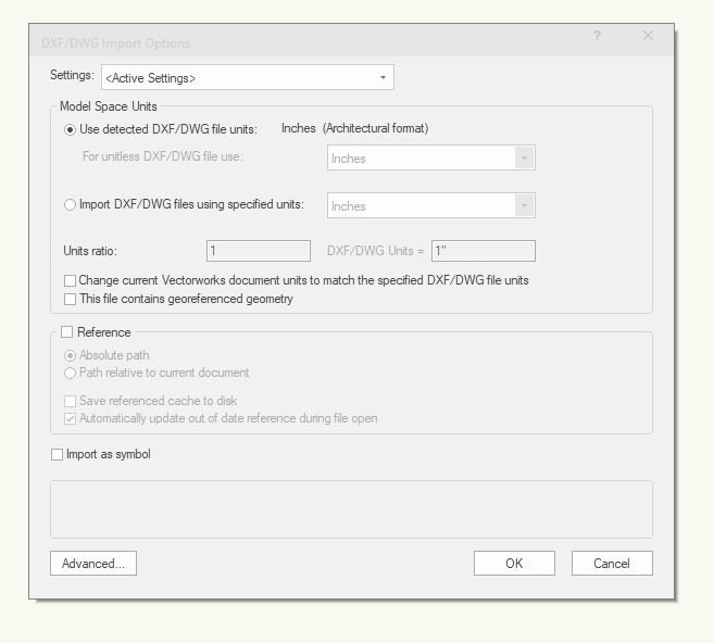

Thank you very much for the help, but, although I eventually got it to work, your solution is not exactly true. The instructions say to first "select this option and" 2. "select the units to use from the pull down list." This does not work. You have to set the pull down list to "Custom" first--which is all the way at the bottom of a very long list in the pull down menu. "Custom" has to be selected FIRST before Units option is not grayed out. This is how it works on my installation of VW2025. The language of this needs to be corrected. MHBrown
In Vectorworks 2025, I am importing a DWG file where I'd like to change the units ratio so that it imports to the proper size. I'm trying this rather than importing and scaling the entire object. No matter what I try, the Units ratio option remains grayed out (see image). A Vectorworks YouTube video from 2018 goes through the process, but has a completely different DXF/DWG Import window that includes "Primary Settings" and other tabbed options. Can anyone explain how to get his option to function in VW2025 and not be grayed out? Thanks, MHBrown
