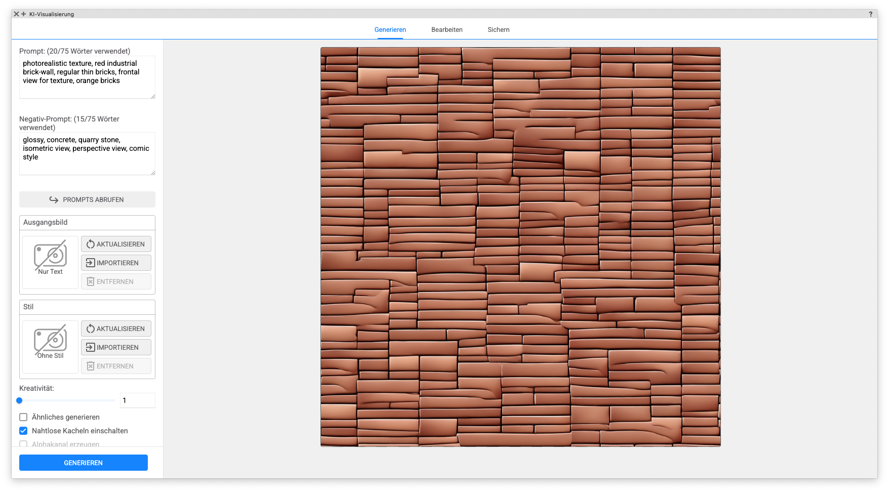

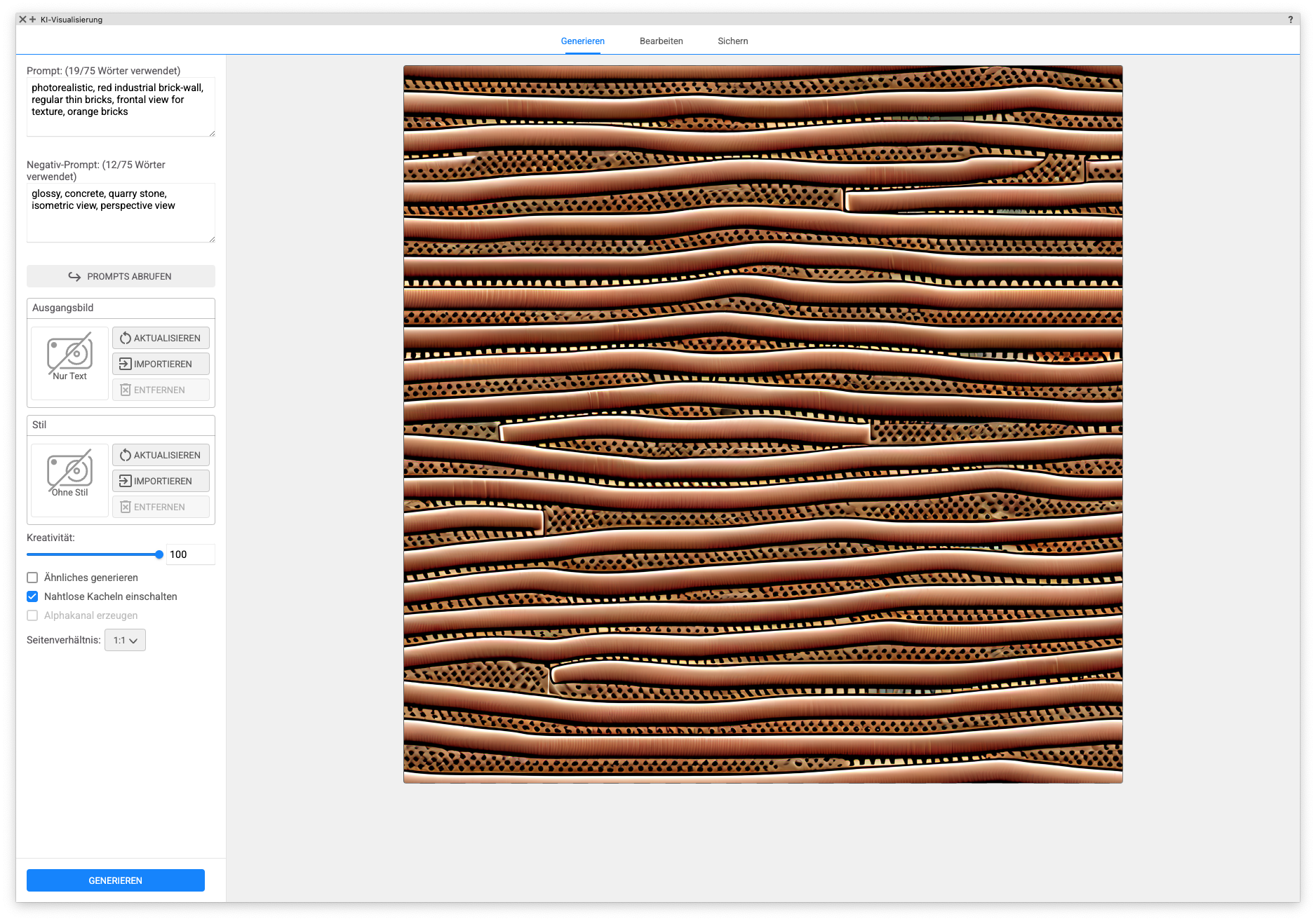

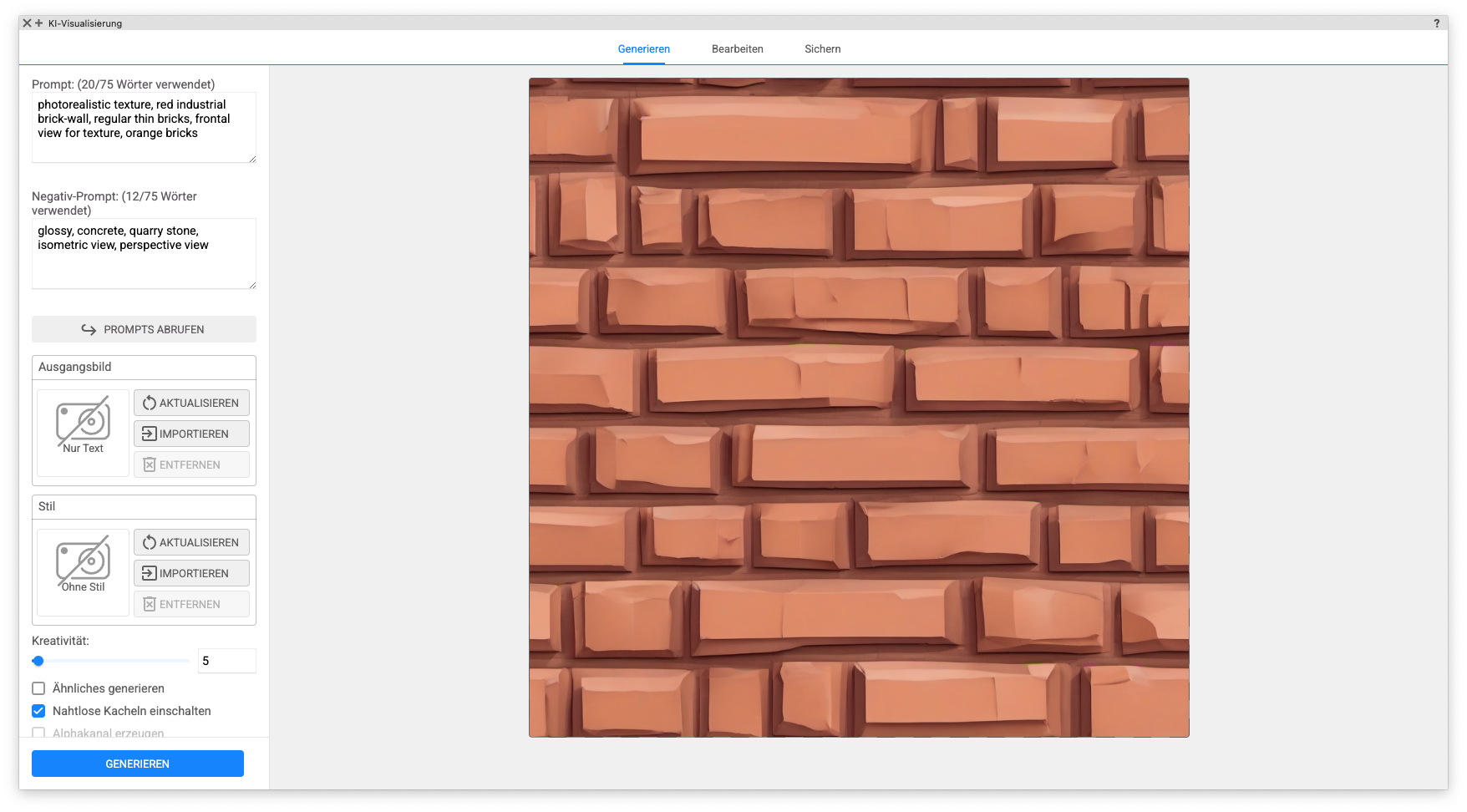

  1. Hi, one of my colleagues had to look for a brick texture online, I thought he probalbly could create it with the AI Visualizer... My first attempts completely failed... Nano Banana did it better (but not seemless) ;-) next try is searching for some advice at chatgpt :-D WHY??? WHY

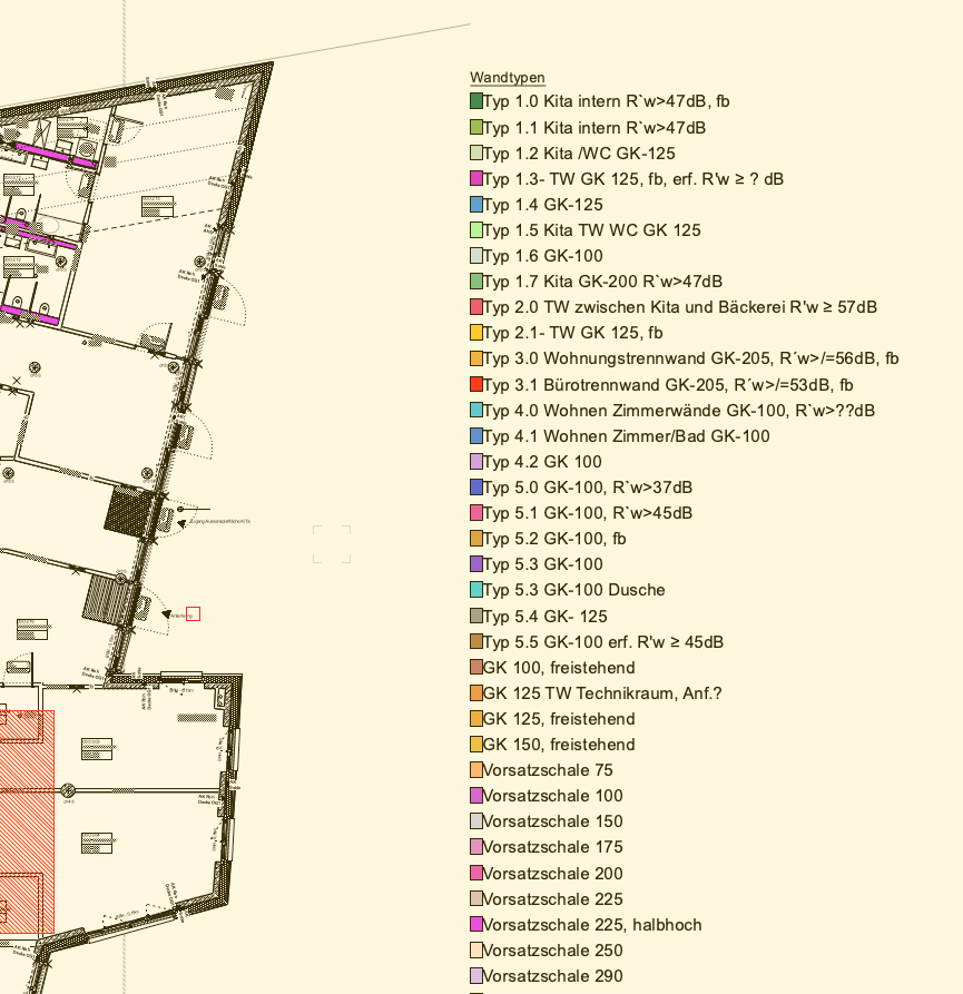

  4. Hi, I'm working on data-vizualizations of combinated data. We want to visualize all plasterboard wall types including their: 1) wall types (from 1.x to 5.5 to ...) 2) fire resistance 3) sound proofing 4) other data Actually my colleagues wrote all that values in one record format field, which in means of the rules I learned how to manage relational databases, records feels wrong. However, if I use separated record format fields, I am not able to create a combinated data-vizualization, or at least I don't know how. I'm able to concat more record format fields in a worksheet. However I am not able to do that in a data viz. Sth like "Make a dataviz from (Concat('Wall-Data'.'WallType';'-';'Wall-Data'.'fireresistance';'-';'Wall-Data'.'sound-proofing';'-';'Wall-Data'.'misc')) Guess, I gotta do it vice versa. Write all that data into one records field and pick the wanted info with a substring, everytime I want to have it parsed....

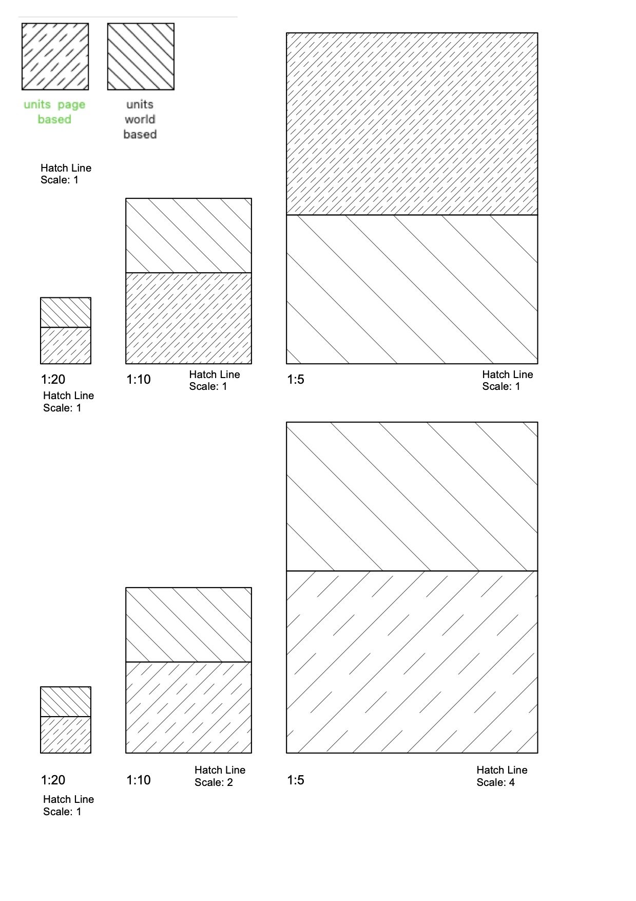

  5. Hi, I actually am trying to to create some studio standards. Now I'm working on hatches and wondered wether it could be possibly possible to work with only one hatch for every material type (like concrete, bricks,...) So I tried both world based and page based scaled hatches and remaind on world based hatches which generally work quite good. Unfortunately in 1:5 scaled viewports hatches are getting a little bit to big. So I tried to scale that hatches via advanced viewport options "hatch line scaling". Unfortunately that only does scale page based hatches, not world based hatches.... I can imagine why this happens but, it's not what I expedet it to be. If I want to scale all hatches inside a viewport, I would expect, that also world based hatches would be scaled but, they aren't scaled. is that OK that way or can this be an error inside Vectorworks? regards, Matteo hatch scale - page vs world_2.zip
