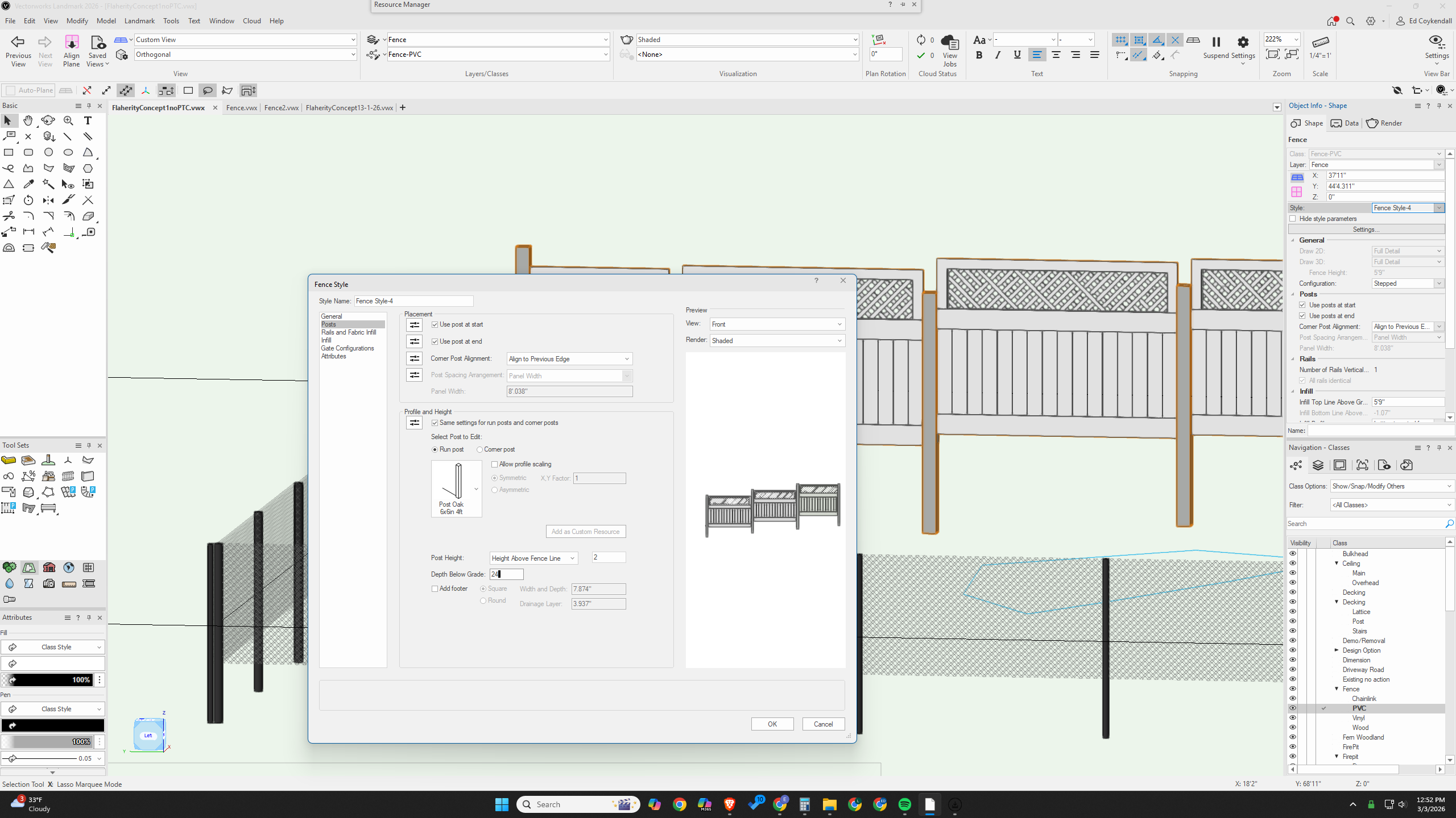

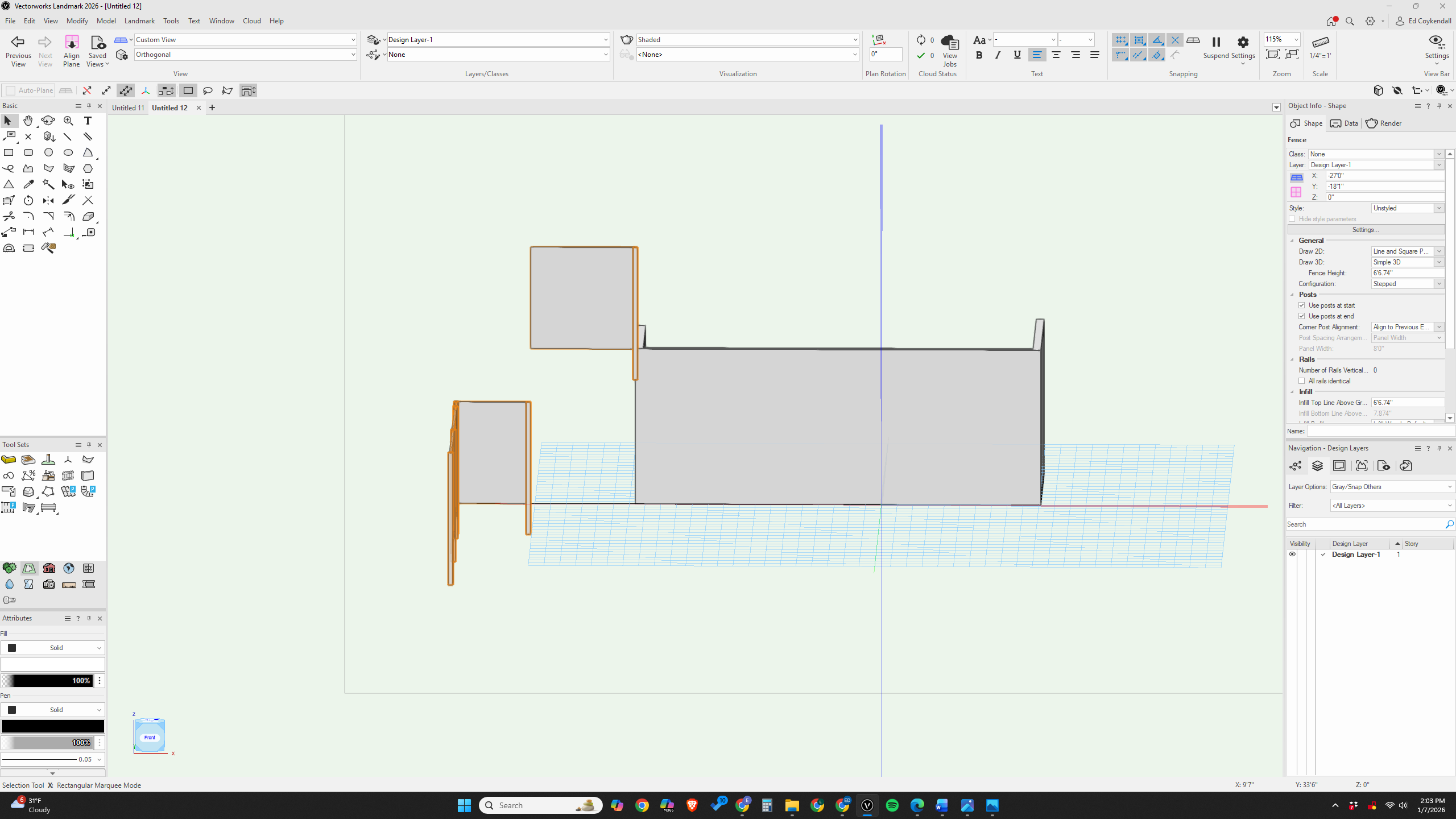

  1. @Scott Lebsack & @Tom W. Ok I got some sort of a fence to work by trial and error. I created a style (Style 4) but new fence sections do not pick up all the attributes automatically. I see my class settings in the attributes are not set properly but are grayed out. How do I edit those so I get a consistent infill and posts each time. The issue I am having now is with the posts. I want them about 2" above the top of my fence. I'm getting the behavior you see in the screen shot. The only thing I can think of is that I modified the stock post and took off the point with the split tool and it changed the object to solid section and thus changed its behavior in the tool. Any input is helpful. FlaherityConcept1noPTC.vwx
  2. Unfortunately I don't have a pic of the fence I want. But if you picture a 48" solid board on board fence with a top and bottom rail with a lattice top 24" with a 3"x3" frame around it is basically it. The wise guy comments are not directed at anyone but to be honest every time I go to delve into a vectorworks tool its total frustration....This should be really simple. I've watched the videos read about it but oddly nothing seems to work as advertized. https://www.bestvinyl.com/blog/what-is-a-lattice-top-fence/ This is close.
  3. @Tom W. just take a drive through any neighborhood. Vinyl board panel with a rail top and rail bottom and if its a fancy piece of plastic it might have a lattice on the top too. I think they are about as plane vanilla and standard as they can be. Almost like a slice of yellow/orange cheese food in a stack all individually wrapped in plastic...One might even say they look trashy. You may be guessing my position on Vinyl fence. I just want to drag drop and forget about it without the Vectorworks nuance....simple, vanilla and boring just like the type of fence. BTW there is a bit of venting in here...nothing personal @Tom W. I find the fence tool to be useless unless you go through the exercise of creating your own resources or your willing to slap in what VW has for resources and explain away to your client the fence isn't even close because you aren't going to spend the time modeling an existing site feature that architecturally is already as aforementioned "trashy" looking. Happy to go through the exercise if a client asks me to design a fence though. I'm hoping someone can tell me different.
  4. I am working on a very simple project and need to simply place a typical white vinyl fence to match the existing one. I am looking for the work flow to do that without "modeling" a fence. I have had luck with some wood textures but vectorworks does not seem to have anything preset for a vinyl fence panel or gate. Its all wood or metal. I definitely do not want to have to invent something thats standard on so many homes. I'd like a click and drop, get close enough and move on. I messed with the attributes panel, messed with textures in the classes menu I created for the fence and for vinyl get a solid white board, I messed with styles. The gates will not let me adjust the attributes at all. The option is grayed out. Looking through the resource manager there is nothing that matches either. The last thing I want to do today is model a vinyl fence. Any advice would be helpful.

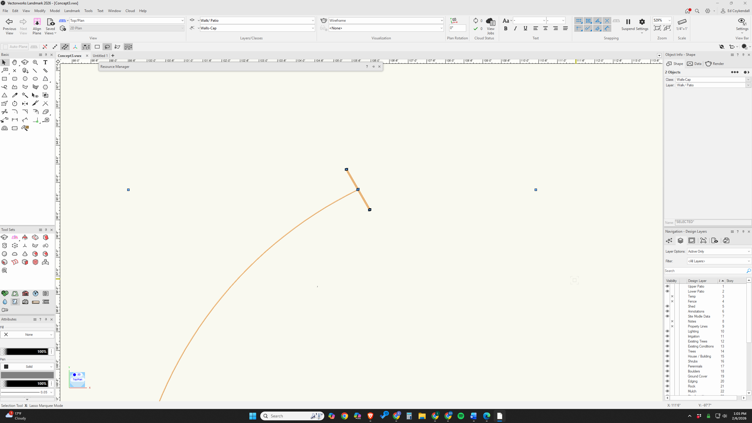

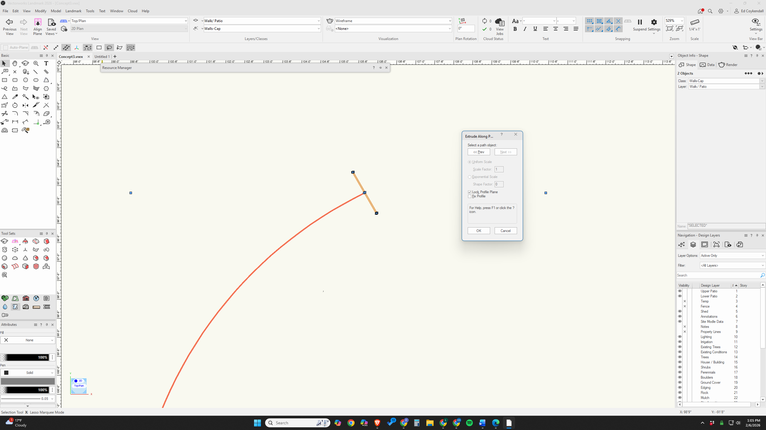

  5. Landartma
    extrude
    I figured it out. The rotation was at 30° I changed it to 90° and there it was. Thanks @Pat Stanford

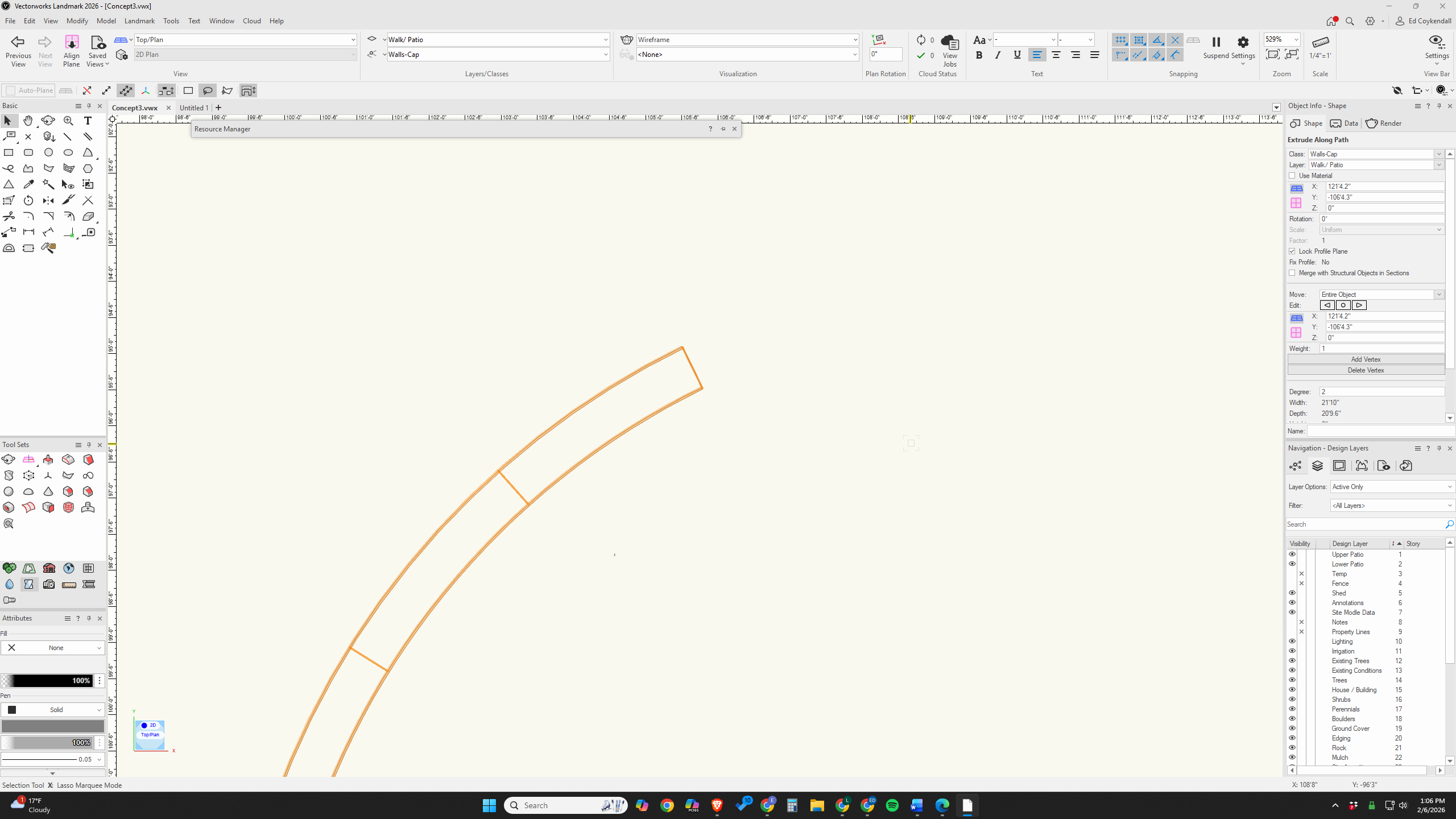

  7. Landartma
    extrude

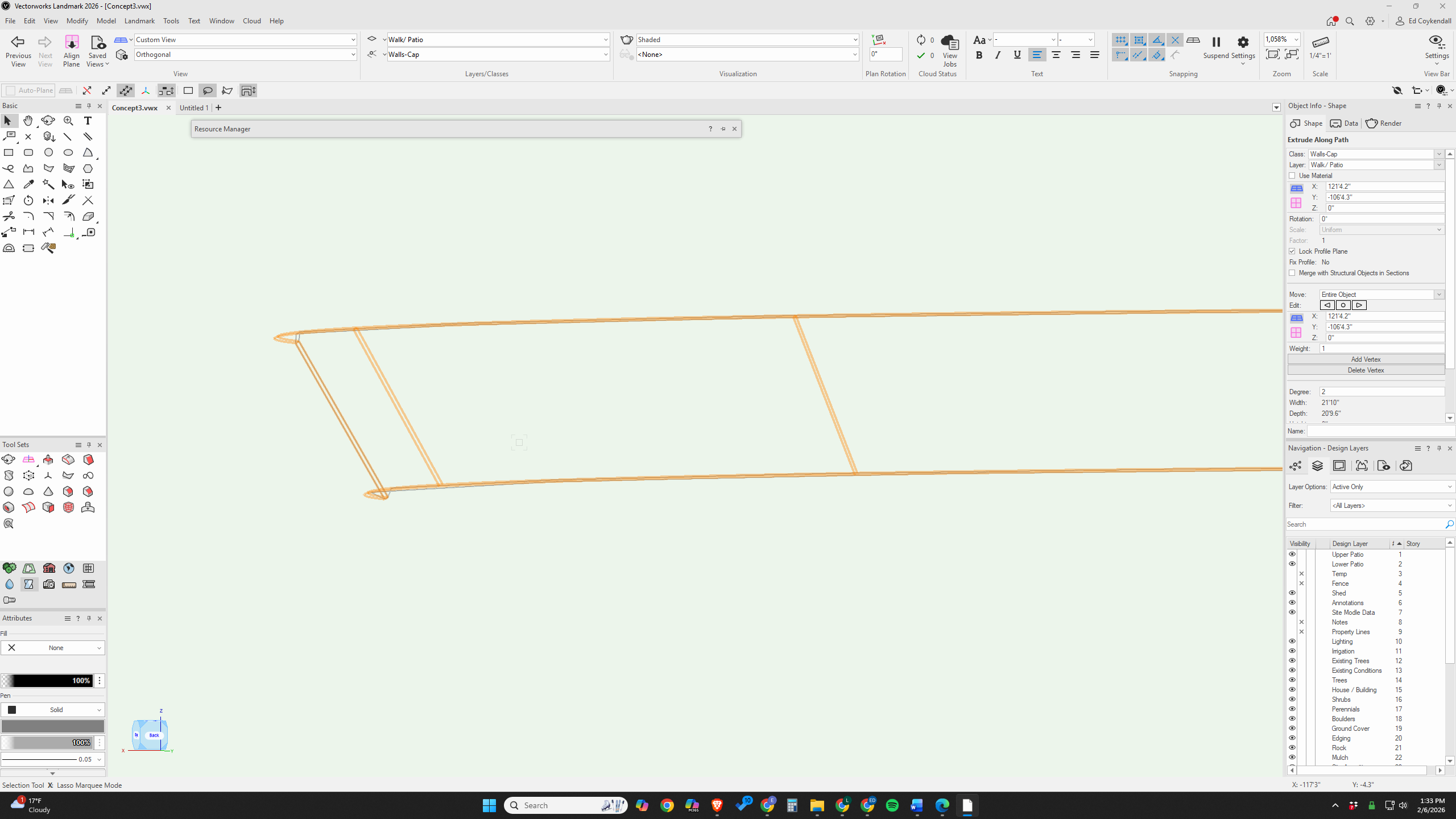

    For some reason I can't get this extrude along path to work. I know I am missing something simple so if someone could enlighten me I would appreciate it. I am making a simple wall cap along a curved path. I started out with a simple extrude and it came out really faceted so I went to extrude along path and it keeps extruding it at an angle to the Z axis. I could just put another small wall on top and call it a cap. But I'd like to fillet the edges on my final. I tried my resolution settings to get rid of the facets to no avail. It almost like I don't have enough vertices on my original shapes.
