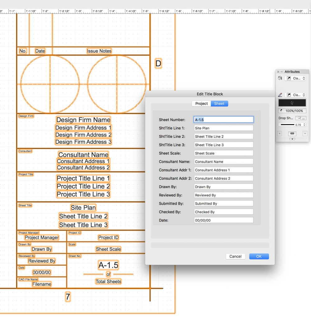

using recordformat, when i duplicate a new sheet, the sheet number doesn't automatically change. This is a small roadblock in terms of creating a lot of sheets. If there anyway to fix this problem (except resnapping sheet border into place?) please see attached file. Untitled.mov
Title block sheet title too long
wingchudesign replied to wingchudesign's topic in General Discussion
Nevermind. Problem solved. Add # to the record format field. -

Hi All, Just learning how to use record format by playing around with title blocks. I'm using one of the standard title block that comes with VW. For some reason, the sheet number is not updating as i duplicate my sheet layers. Though the "sheet number" changes under the navigation palette. The sheet number in my actual page (linked to the record format) does not change. (see attached) I was wondering if there was a workaround to this problem.

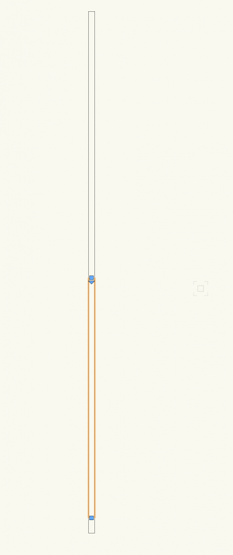

last request of the day and a strange one at that - thought it would be nice to join straight walls (see attachment). why? There are a lot of times when i draw a wall, split the wall for some design purpose, only to realize that i didn't want that. I don't think you can "compose" or "rejoin" straight walls even though we can do it with 1. linear dimension and chain dimensions 2. polygons and 2d shapes.
