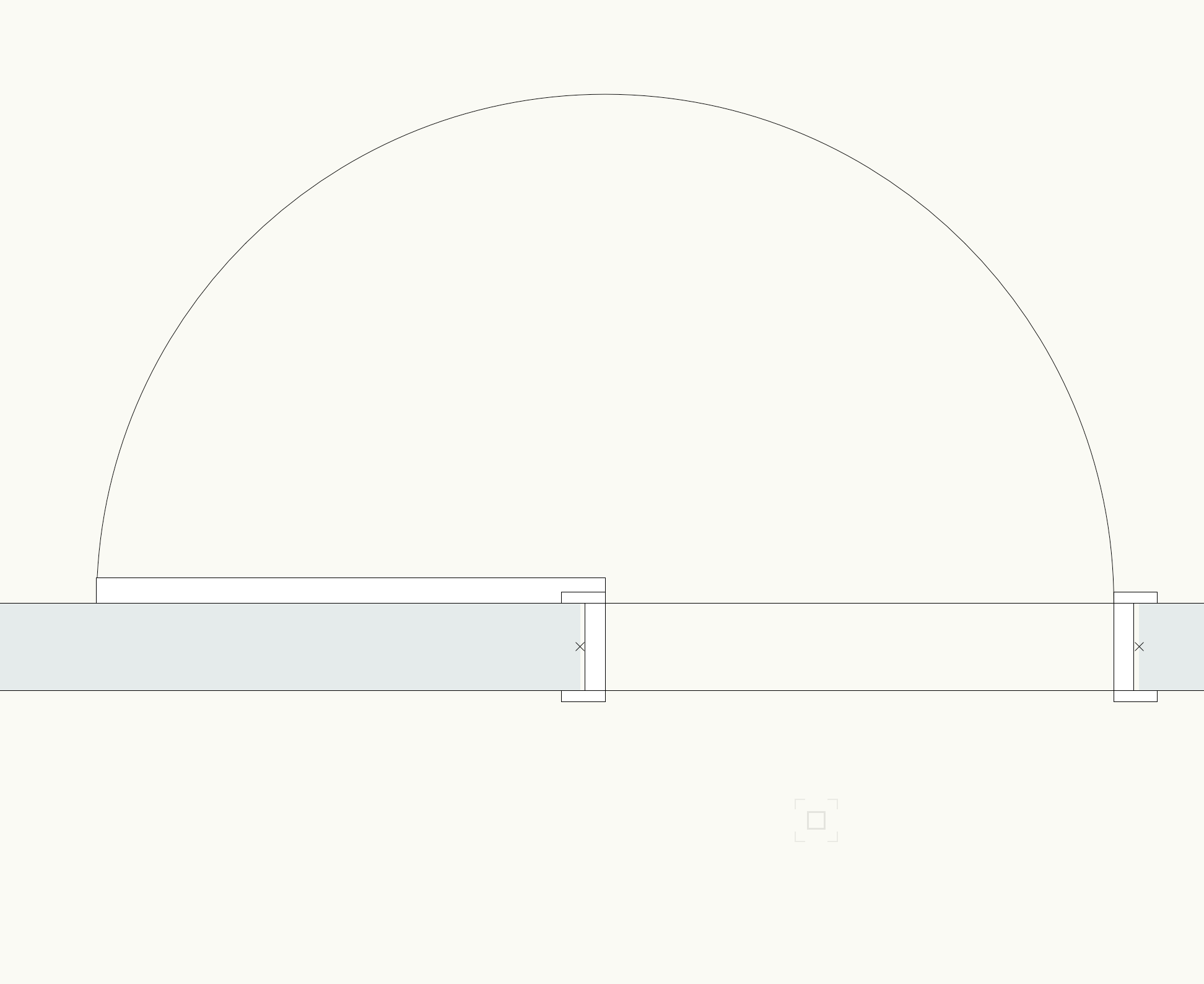

Graphically, when you call for a 180° door swing, it overlaps with the trim. instead of swinging clear of it. Am I missing something?
