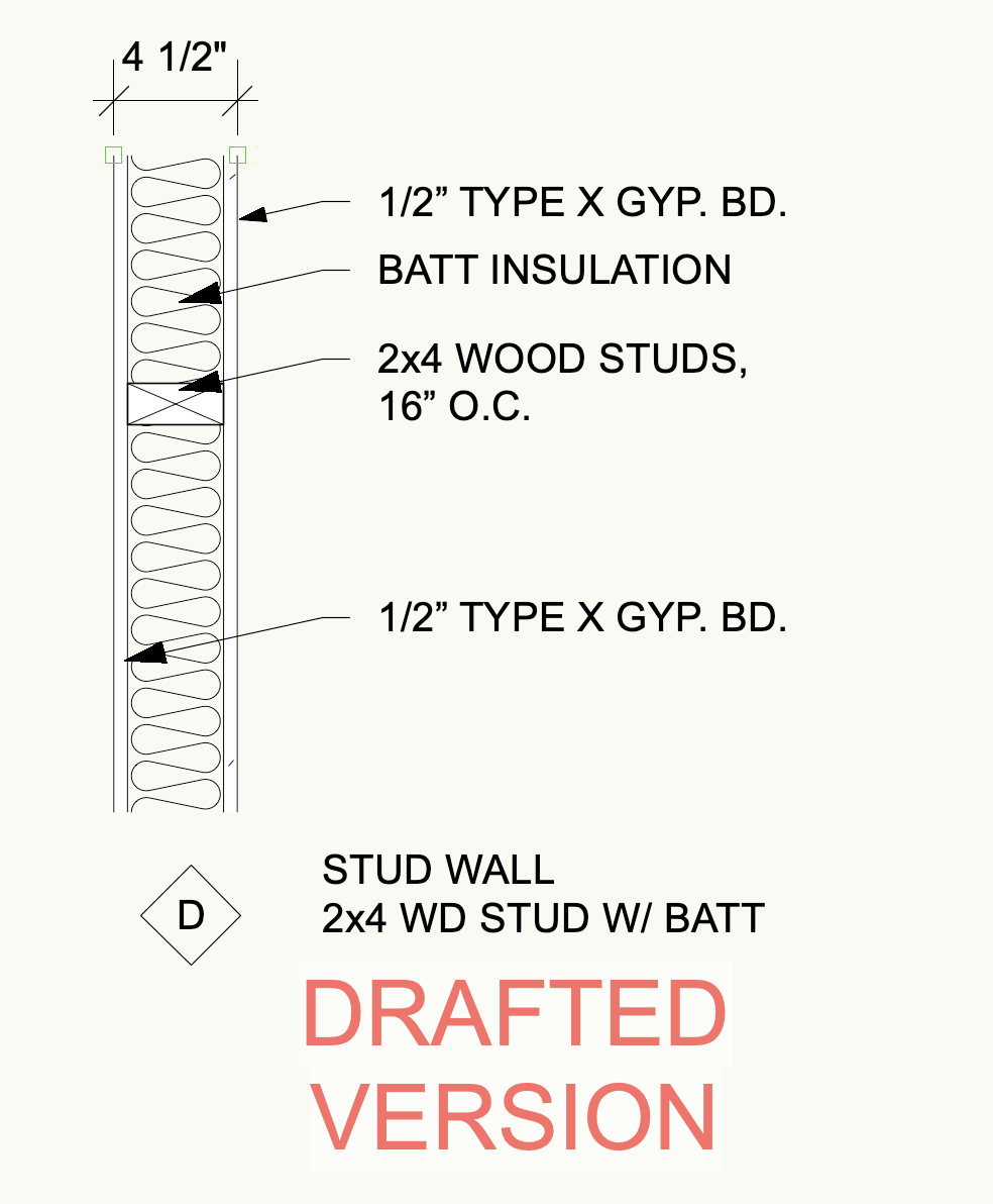

Existing, Demo and Proposed work flow in a BIM world I see a number of post on the subject of how to work with Existing, Demo, and Proposed items in a drawing set. All of the answers look like work arounds that are fine for simple drawings or a 2D drawing. Building a model using stories, styles and BIM objects change everything. The more I work with VectorWorks the way I believe it is designed to work the easier it is be to build and maintain standards and transition between versions. To work in the BIM world it is important it is to control lots of objects with classes and think of layers as floor levels. Problem with setting up a basic architectural drawing I believe a core process of anyone using VectorWorks for Architecture is to draw existing walls and doors, be able to turn some walls and doors into demo work, then add new doors and walls. I can do all of this and maintain my building model, but I need to create 3 versions of every class and/or style. Setting up classes or styles for one project is not a big deal but you don't want to customized every item in every project you work on. Setting up templates, symbols and styles for new, existing and demo is really to much to manage. Proposed Solution for VectorWorks to consider Draw your walls and insert your doors Click the doors and or walls you want and designate them as "demolition, proposed, existing, phase one or phase two" This could be managed with a check box in the object info pallet or as sub class. (maybe even a right click with the mouse) The class might be "door main and a sub class might be "door main - Existing" You would need be able to control visibility and graphics but not have to manually make then assign all the parts of a wall or door to another class You might even be able to turn on auto classing A bonus feature might be: If you demo a door you tell it how to infill the hole in the wall, maybe a new wall or a new door.
