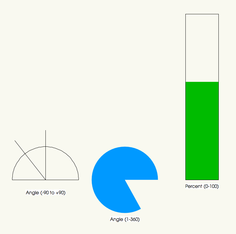

I really like the functionality of the new Slider node in Vectorworks 2017. It has a good amount of flexibility. Here are a few examples of it used for Angle (-90 to +90 range), Angle (1-360 range) and Percent (0-100).
