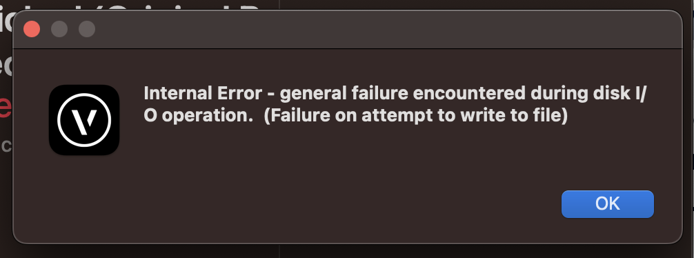

  1. Hi, I keep getting the following message below when importing a DWG. We work off a server, which we found amplifies the issue, so we save the VWX file and DWG onto my MacBook for this process. I import the DWG into VWX, I then get this message and VWX crashes. I then have to reopen VWX which takes an eternity, reopen the VWX file and re-do the import - it works. Happens with every drawing I need to import? Anyone else getting this? Any suggestions on how to fix this? Aiden
